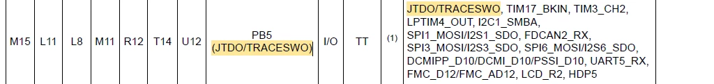

Hello Team,
We are developing a custom board based on the STM32N657 MCU. During pin assignment in the CubeMX tool, PB3 is shown with the JTDO_SWO function. However, the datasheet indicates that the SWO functionality is associated with PB5.
Could you please confirm which pin actually supports the SWO function?

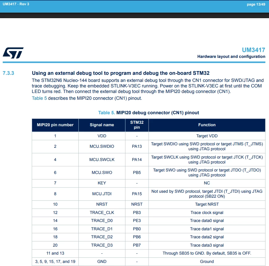

The User Manual for the NUCLEO-N657X0-Q (MB1940) shows SWO as PB5:
via: https://www.st.com/en/evaluation-tools/nucleo-n657x0-q.html#documentation

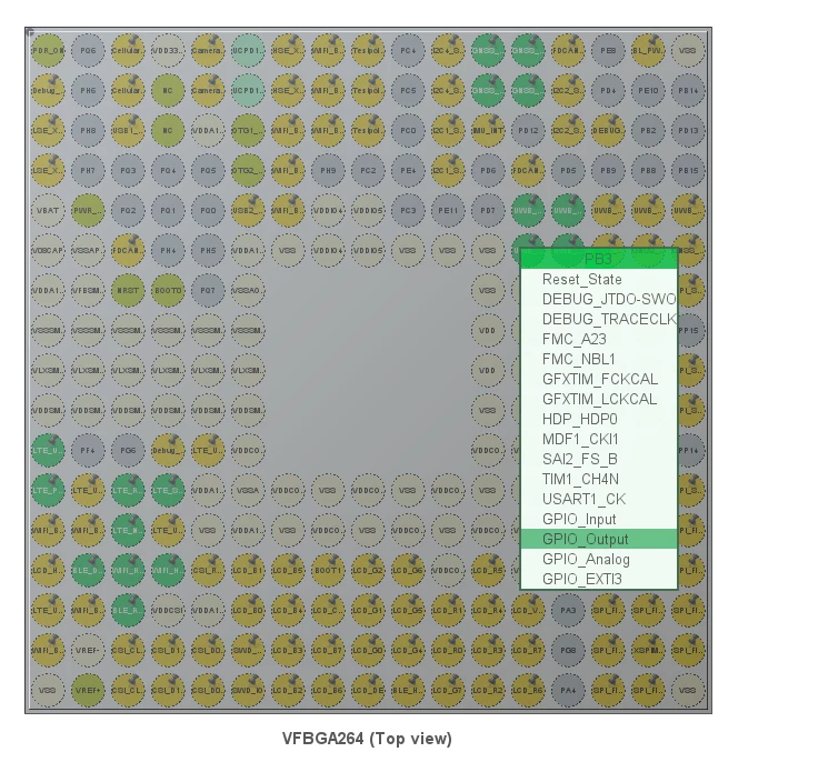

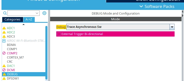

you did/have to choose in Cube   :
..then the needed pins swd, sdc, swo are set/used for this.
On other cpu, here H743 :
But from ds it is PB5 on N657.
If wrong pin is set by Cube ...found a bug.

Pavel A.
Aug 22, 2026 5:06 PM UTC
If you click on PB5 will you see SWO there?
