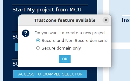

I have STM32N6570-DK and i would like to disable or make Trust Zone transparent to me and develop the project without safety like your products with cortex M3,M4 and M7 cores with all resources available.
I can find some video content on disabling Trust Zone on STM32L5 and STM32U5 but not for STM32N6.
STM32CubeIDE offers me a Secure or Secure-Non Secure project generation. Any tips ?
Thank you

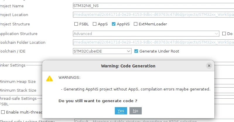

Hello @Laney, and welcome to ST community!
In the Project Manager, you can select AppNS to generate only the non-secure version of the project, which is most likely what you are looking for.

Hello @STackPointer64 ! Thank you for reaching out, and happy new year to all.
I've tried suggested. To generate only non-secure project. CubeMX prompted the warning, and after the generation the code does not build.
 Also, in the CubeMX new project wizard, there is no option to generate only non-secure or trust zone disabled project. Is this currently not supported or ? Screenshot from 2026-01-01 13-14-09.png

Hello @Laney ,
I stand corrected; please excuse the misinformation in my previous message. Due to the architecture of N6, both secure and non-secure projects need to be generated for successful compilation. Regarding using the MCU more traditionally like Cortex-M3 to M7 (except M33, M35P, and M55), the only way is to enable and configure peripherals in the Non-Secure domain (AppNS). After generating the project, you should edit only the non-secure project. That’s all.

Hi @Laney
Due to its architecture, it's not possible to disable TrustZone on STM32N6.
After reset, the device always starts the BootROM execution in secure mode, then jump in a FSBL application which is still in secure mode.
From CubeMX you have the possibility to generate projects as below:
- FSBL + Application Secure
- FSBL +  Application Secure + Application Non Secure (integrate firmware isolation)
If you do not need this security model, you should use other STM32 device without TrustZone feature.
