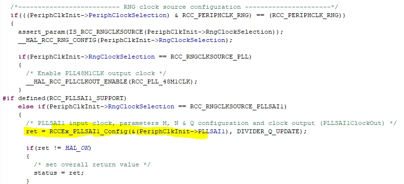

I am getting error in auto generated code. While doing Init for RNG peripheral at very first time just after flash  it's going in error loop and later upon reset, it is working fine. This behaviour I observed in debugging mode.
What is the issue can you help?

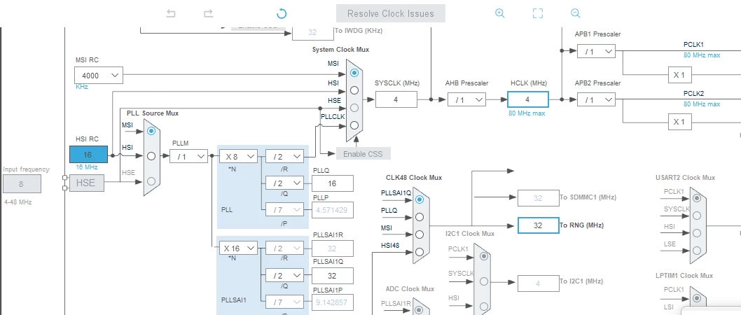

can you please review newly added attachments?

This is code is auto generated while I enabled RNG peripheral
Added image of IOC file
please look again

The posted/highlighted code is not in HAL_RCCEx_PeriphCLKConfig, but in RCCEx_PLLSAI1_Config().
What is content PllSai1 and how is the PLL source set (i.e. what is content of RCC->PLLCFGR) at that moment?

added Ioc image

Could you confirm the same issue using different clock source or decreasing clock frequency? According to the reference manual, RNG Clock source CLK48SEL is used to select 48MHz Clock. Are you sure about the MSI clock configuration being used?
