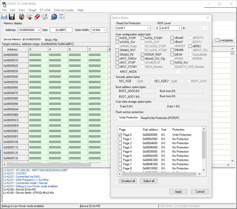

If I try to read the device flash memory using ST-LINK Utility I get this:

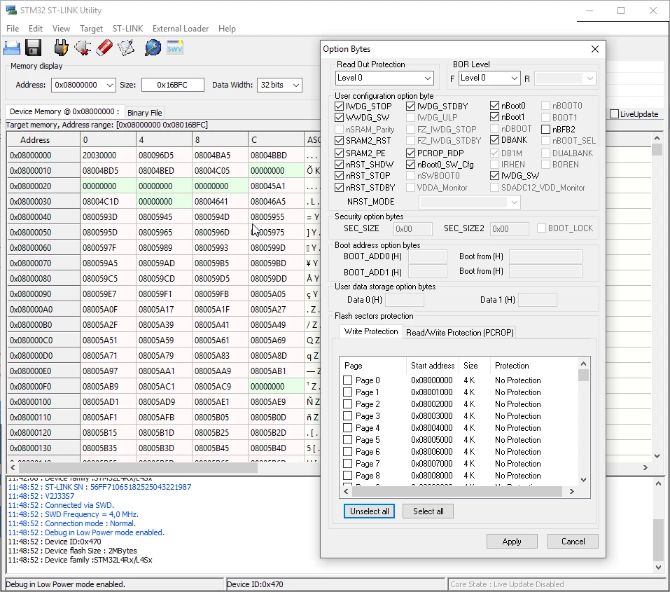

I can only read zeros and the read protection is suddenly set to level 1. If I disconnect the device from power und connect it again, I can read the flash memory just fine.
The read protection is set to Level 0 again.
