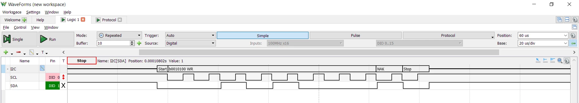

Daniel
Update:
I've unpluged the nucleo board and plugged it back and it appears that the code runs.
After loading the code it gets stuck, but if you reset the power (unpluging and pluging back) it works, as seen in the image.
I don't know why it gets stuck after loading the code though.
