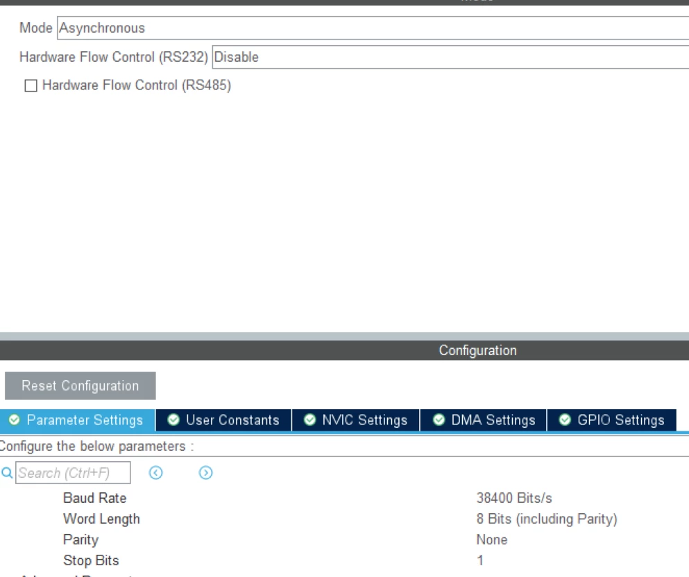

STM32L432 UART receive IRQ handler unable to created by Cube
Hi, guys, anyone has met such an issue?
I was trying to generate code by CubeMX, and I also wanna generate USART1 IRQ handler but failed.
here are my settings, anyone can help me with this?
thanks

Apr 18, 2024 8:28 PM UTC
Are you looking at the correct file where it gets generated?
If a reply has proven helpful, click on Accept as Solution so that it'll show at top of the post.CAN Jammer an open source CAN bus hacking toolCANableV3 Open Source
LU998Author
Apr 19, 2024 1:23 AM UTC
the IRQ handler should be at main.c ?
Karl Yamashita
Karl YamashitaBest answer
Apr 19, 2024 6:47 AM UTC
Umm, no. It's in stm32l4xx_it.c file.
But you shouldn't need to do anything in that file anyways. All your coding would be done in the callbacks which are in stm32l4xx_hal_uart.c or stm32l4xx_hal_uart_ex.c. You just override the weak callbacks that you want to use.

LU998Author
Apr 19, 2024 7:23 AM UTC
thanks anyway
