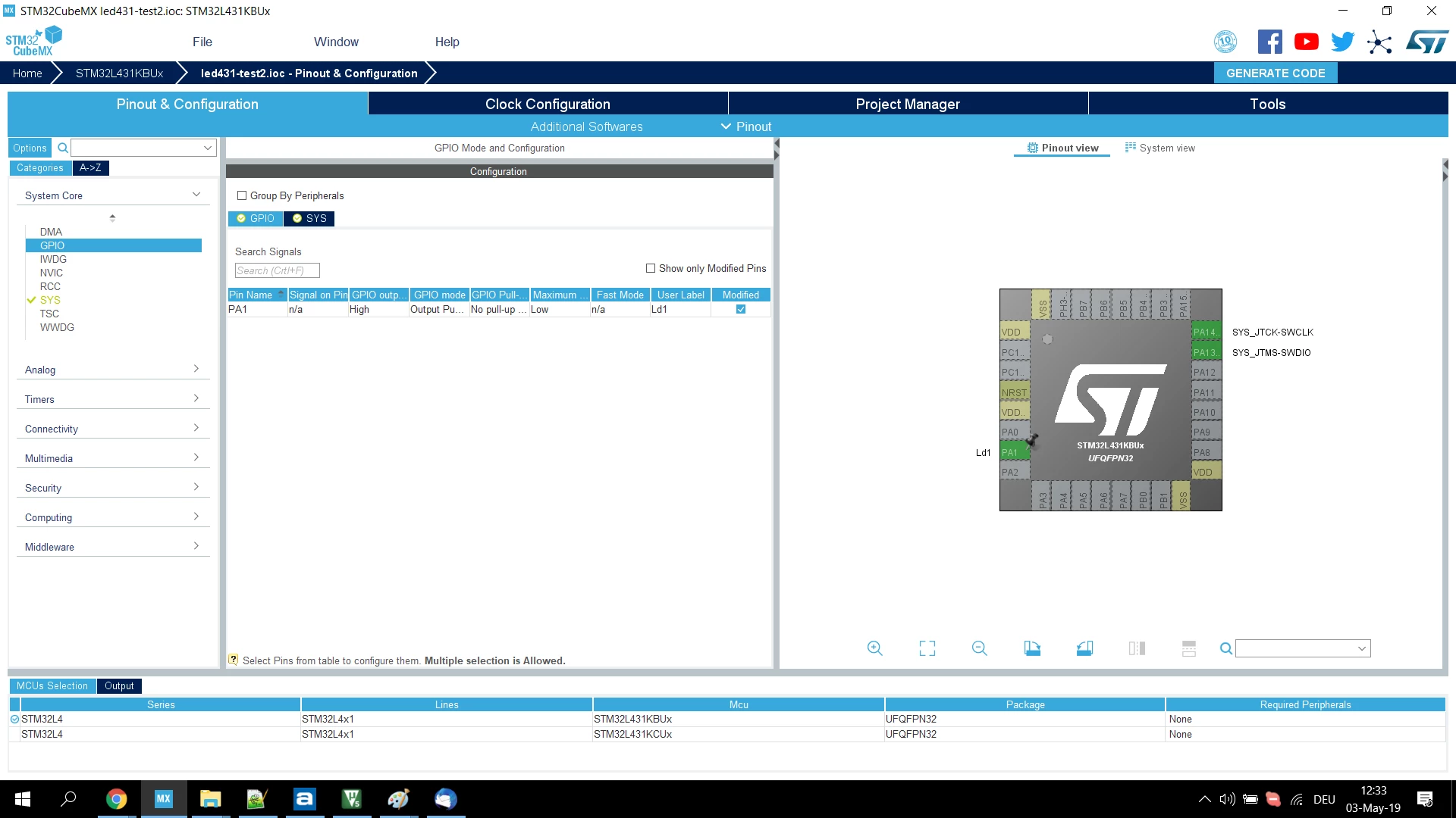

So I got this STM32L431KBU6 chip on breakout and I can't get it to start. Here is the GPIO config, 0690X000008BEo0QAG.png

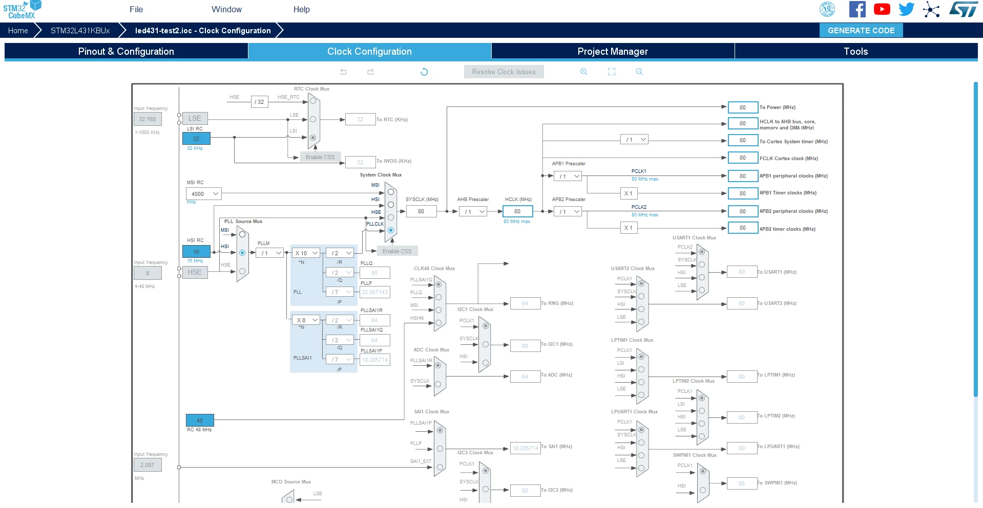

and the clock config. That is one from many I tried, I only tried with with internal clocks, MSI in different configs and HSI with different combinations of multipliers and dividers 0690X000008BEpDQAW.png

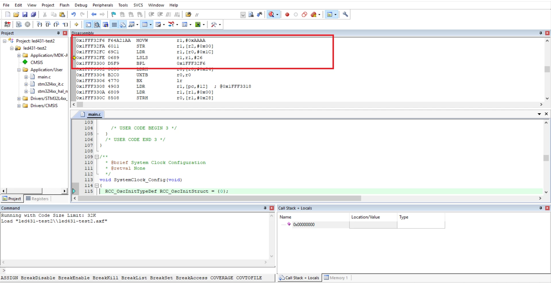

When I run a debug in Keil, I just can't get past some cycle. I think it's already some error handler, but I don't get it shown in C code.0690X000008BEojQAG.png

Pull BOOT0 Low​

beatloman91
May 3, 2019 1:40 PM UTC
Thank you very much! That helped, although I'm still confused as to why it wasnt't needed on stm32l412K8t6? The "Boot modes" parts on both datasheets are basically 1 to 1, there is no difference I can read about in datasheet.
