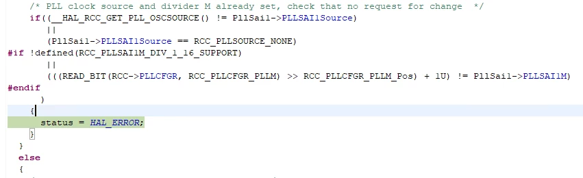

Abhi_Data
October 17, 2023
I am also facing the same issue at below code place:1.PNG

Abhi_Data
October 17, 2023
Have you found the workaround for this issue I am also facing the same ?
