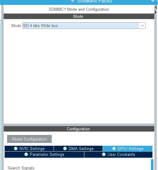

stm32l4 64 pin and SDMMC 4 bits wide bus
0693W000006FFWVQA4.png0693W000006FFWfQAO.pngHello, I'm using an stm32l496rgt (64 pins).

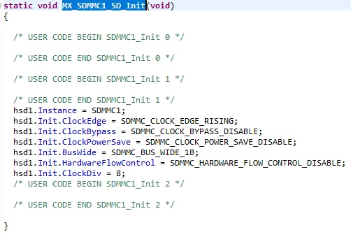

When I set SD 4 bits wide bus on SDMMC I noted that the code created set SDMMC_BUS_WIDE_1B instead of 4B.
In this configuration the sd card doesn't work, it works only with 1 bit bus.
4 bits data bus works properly in stm32l4r5zit6p (144 pins).
Is there a problem on 64 pin version?

Dec 10, 2020 2:02 PM UTC
The chip always comes up in 1 bit mode and is switched to 4 bit mode through a later call.
In your linked code, it doesn't even call HAL_SD_Init, so the generated code is missing.
I generated a new project, selected 4 bit SD, and the generated code came out correct:
 * @brief SDMMC1 Initialization Function
 * @param None
 * @retval None
static void MX_SDMMC1_SD_Init(void)
 /* USER CODE BEGIN SDMMC1_Init 0 */
 /* USER CODE END SDMMC1_Init 0 */
 /* USER CODE BEGIN SDMMC1_Init 1 */
 /* USER CODE END SDMMC1_Init 1 */
 hsd1.Instance = SDMMC1;
 hsd1.Init.ClockEdge = SDMMC_CLOCK_EDGE_RISING;
 hsd1.Init.ClockBypass = SDMMC_CLOCK_BYPASS_DISABLE;
 hsd1.Init.ClockPowerSave = SDMMC_CLOCK_POWER_SAVE_DISABLE;
 hsd1.Init.BusWide = SDMMC_BUS_WIDE_1B;
 hsd1.Init.HardwareFlowControl = SDMMC_HARDWARE_FLOW_CONTROL_DISABLE;
 hsd1.Init.ClockDiv = 0;
 if (HAL_SD_Init(&hsd1) != HAL_OK)
 Error_Handler();
 if (HAL_SD_ConfigWideBusOperation(&hsd1, SDMMC_BUS_WIDE_4B) != HAL_OK)
 Error_Handler();
 /* USER CODE BEGIN SDMMC1_Init 2 */
 /* USER CODE END SDMMC1_Init 2 */
This has come up before, so there's likely a bug somewhere but I can't reproduce it.

Thanks for your reply, you are right, the 4 bit wires where set in BSP_SD_Init.
But we have found problems using dma, solved with the help of this link:
https://community.st.com/s/feed/0D50X00009XkVtKSAV
Best Regards
