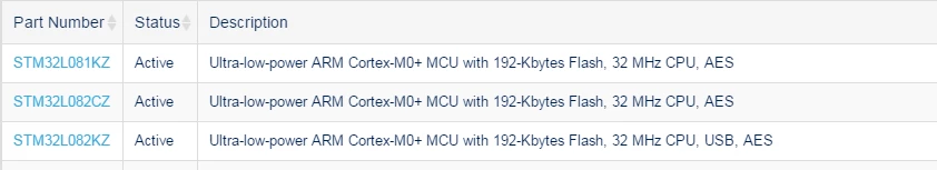

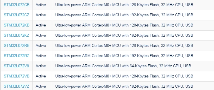

STM32L082xx WLCSP49 Not in CubeMX
Posted on February 08, 2017 at 23:03
STM32L082xx WLCSP49 Not in CubeMX - can the stm32l072czex be used instead? what is the difference between these two parts?

The difference betwwen STM32L082xx and STM32L072ss is described below :
The difference lies in the AES (Advanced Encryption Standard).
In CubeMX 4.20, STM32L082CZYx (WLCSP49 package) will be available. So please, upgrade your CubeMX release as soon as CubeMx 4.20 will be available.
BR. Eric
