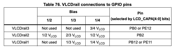

I’m setting up a new project in STM32CubeMX for an STM32L073RZ using the internal LCD controller in 1/3 bias mode.
According to the STM32L0 reference manual (RM0367), the LCD voltage rails should be configured as:
PB12 - VLCDrail1
PB2 - VLCDrail2
However, in STM32CubeMX, the GPIO configuration only allows:
PB12 - VLCDrail2
PB2 - VLCDrail2
There does not appear to be any option to configure either pin as VLCDrail1.
Am I misunderstanding the LCD rail configuration for 1/3 bias mode on STM32L073RZ, or is this a limitation/bug in STM32CubeMX?
Thank you!

ECSLAuthor
Jun 23, 2026 10:51 AM UTC
Hi Mahmoud,
Thank you. Is there any update on the ticket?
In the meantime, would it be sufficient to configure PB2 as LCD_VLCD2 and add this code after the LCD initialization?
GPIO_InitTypeDef GPIO_InitStruct = { 0 };
GPIO_InitStruct.Pin = GPIO_PIN_12;
HAL_GPIO_Init(GPIOB, &GPIO_InitStruct);
__HAL_SYSCFG_VLCD_CAPA_CONFIG(SYSCFG_VLCD_PB12_EXT_CAPA_ON | SYSCFG_VLCD_PB2_EXT_CAPA_ON);
