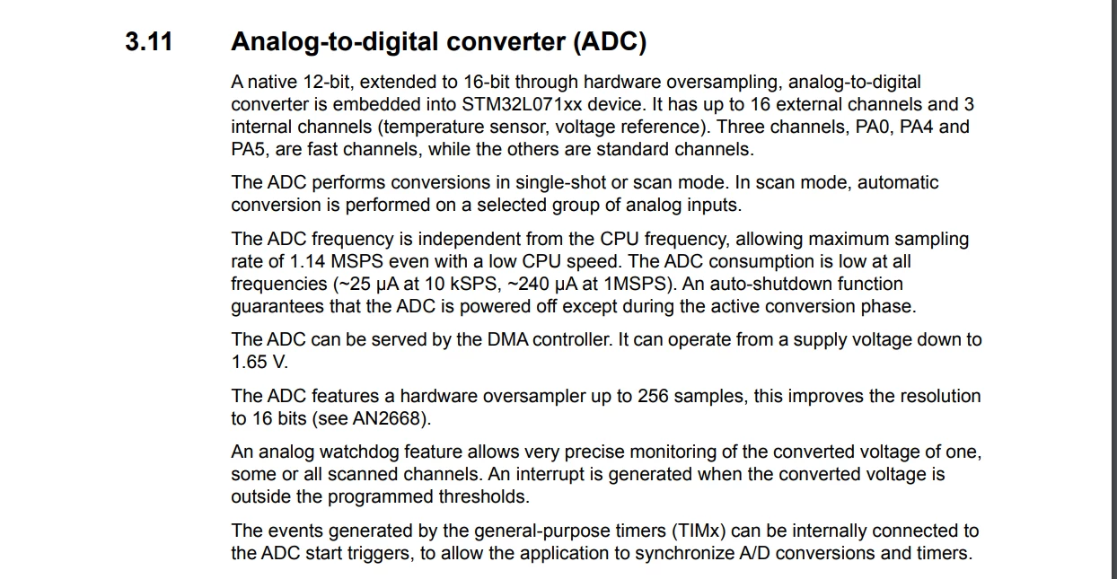

UPDATE:
I have found where they mention scan mode in the documentation of the STM32L071:
However, it wont let me configure this in the cubeMX

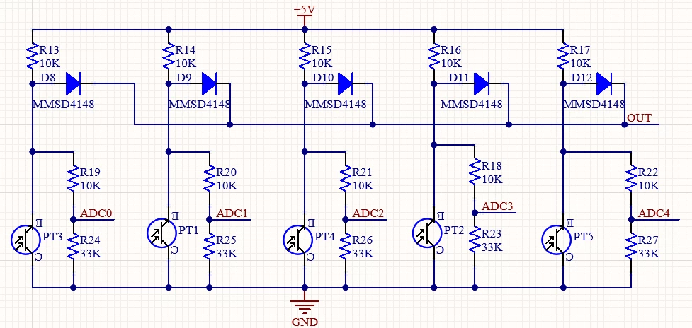

The following is a schematic:

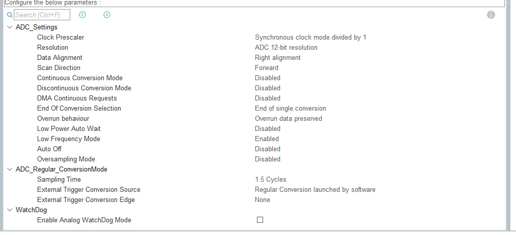

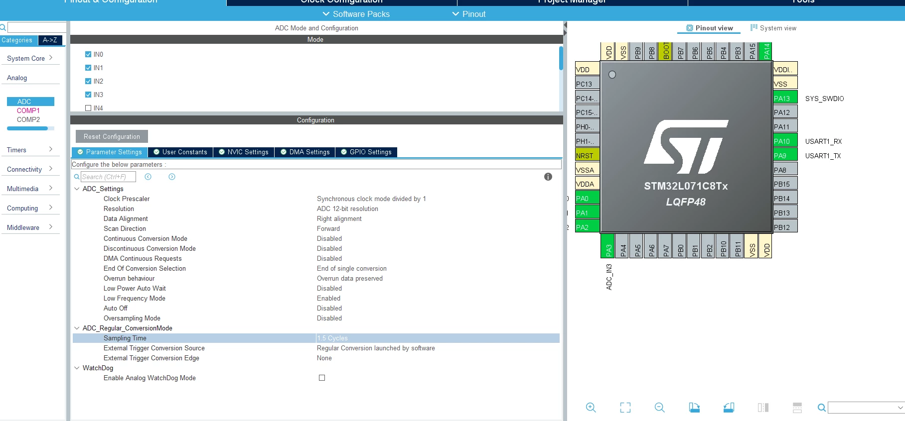

And the cubemx confguration:

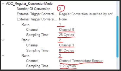

In the cubemx, I should be able to configure my channels as it shown in this example :
However, in my cubemx, I have no such options:
