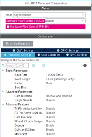

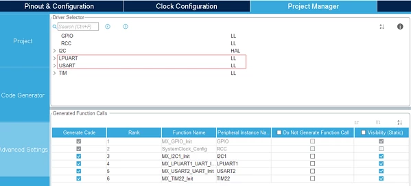

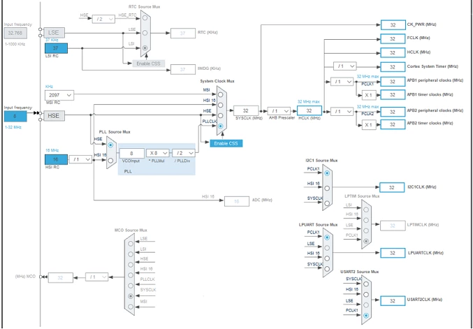

[STM32L031G6Ux] LPUART LL ISR Routine - defense code for prevent unknown error
As follows, LL UART interrupt code with ring buffer were compose.
0693W00000QMDhzQAH.png0693W00000QMDi4QAH.png0693W00000QMDi9QAH.png​

I don't know why, but in connection with a particular device, the ring buffer's head & tail index mismatch error was solved by adding the following if statement in the ISR function.
if (0 == Uart1_recvDataSize) { Uart1_recvPop = Uart1_recvPush = (Uart1_recvPush % COUNTOF(Uart1_recvData));
And the reason is unknown, but when the interrupt UART TX function was used using the TX function below, the first & second BYTEs were broken, so the TX function was moved to the main() function and resolved the data was broken.
// LL_USART_EnableIT_TXE(LPUART1);
I don't know if it was caused by another problem with my code,
If there is a user who can experience something similar to me,
I leave the above test results to help you.

The example I posted above seems to be a little different from your problem.
Using the LL UART interrupt TX with the STM32L031+Example above, the operation works fine about 0.5~1 hour. However, RX ring buffer index mismatch & TX data is broken after some times, so add "safe if" & the TX routine has been moved to the interrupt -> main() function.
