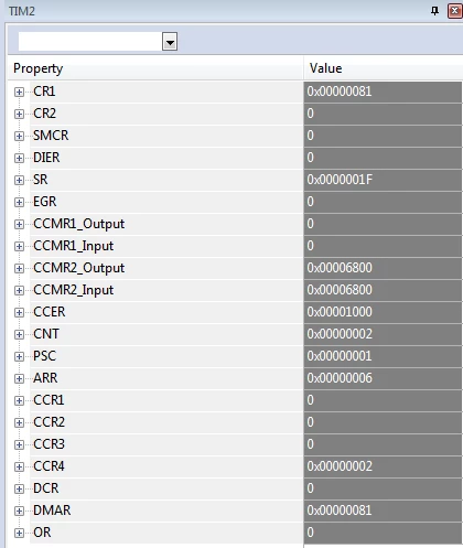

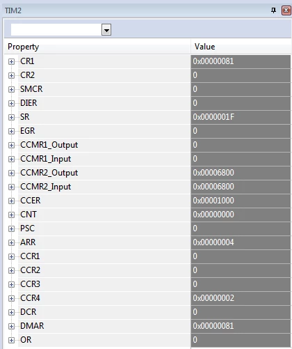

SSkje.1
SSkje.1Author
Mar 23, 2020 10:46 AM UTC
I have a logic analyzer connected to TIM2_CH4 / PB1
non-working (CNT register counts, while PSC is zero, but nothing happens on the hardware pin)
working - now output pin has PWM:
(attempt two, uploading files)
 I can expand any registers if needed
berendi
Principal
Mar 23, 2020 11:03 AM UTC
Check GPIO OSPEEDR setting for the output pin. What is the APB clock frequency of the timer?
CCR4 has the same value in both cases, so the pulse witdth (duration) is shorter when PSC=0.

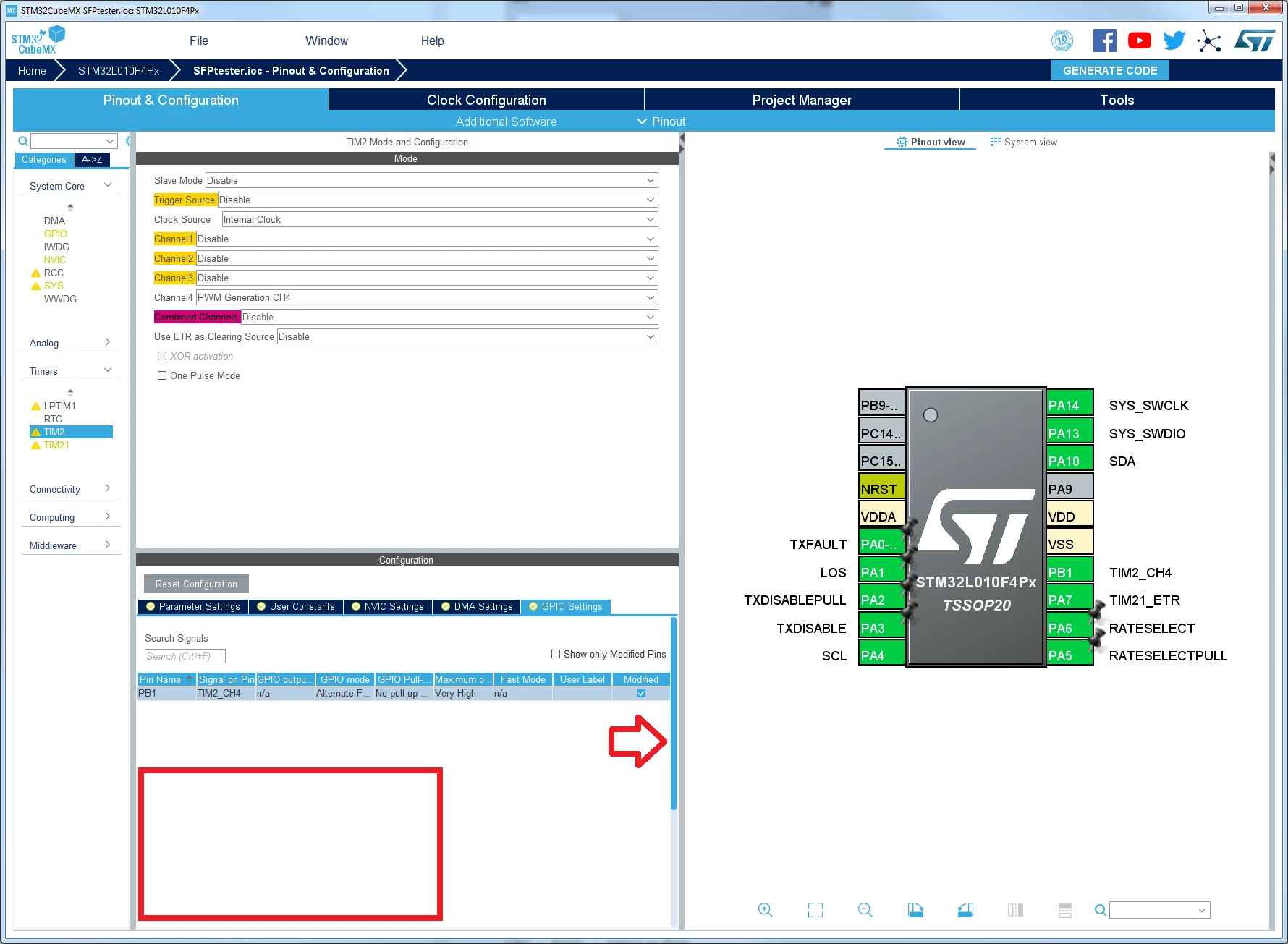

SSkje.1
SSkje.1AuthorBest answer
Mar 23, 2020 11:14 AM UTC
OSPEED was set to "LOW". Increasing it to "VERY HIGH" did the trick.
thank you
(STM32CubeMX hides it away - you have to scroll the option into view in order to notice that you can change this)
