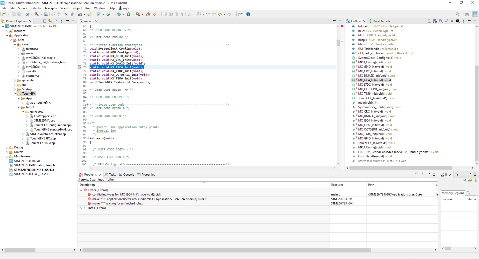

STM32H7B3I-DK__Build Errors__MX_I2C4_Init__have void (void)
Dear Sir,
Hardware: STM32H7B3I-DK
Software: STM32MX 6.12.1 / STM32CubeIDE 1.16.1 / TouchGFX 4.24.1/ STM32Cube_FW_H7_V1.11.0/2
Programming for using the STM32H7B3I-DK according to STM32 Graphics Workshop; started with STM32MX, did each step refer to the pdf file (EXTRA-Lab Startup Project Full CubeMX Setup.pdf from Slides.zip). After completion of the programming, fixed some errors found from build errors by myself; but this MX_I2C4_Init__have void (void) build error still remain.

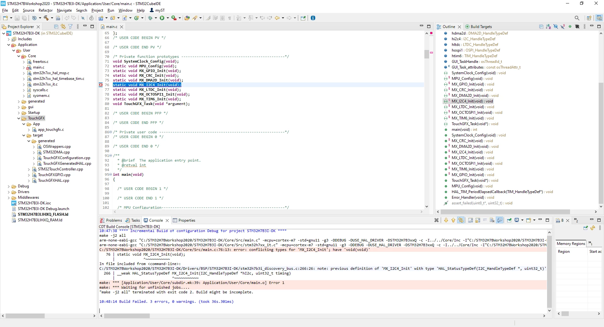

Below are the build errors message details:
1.

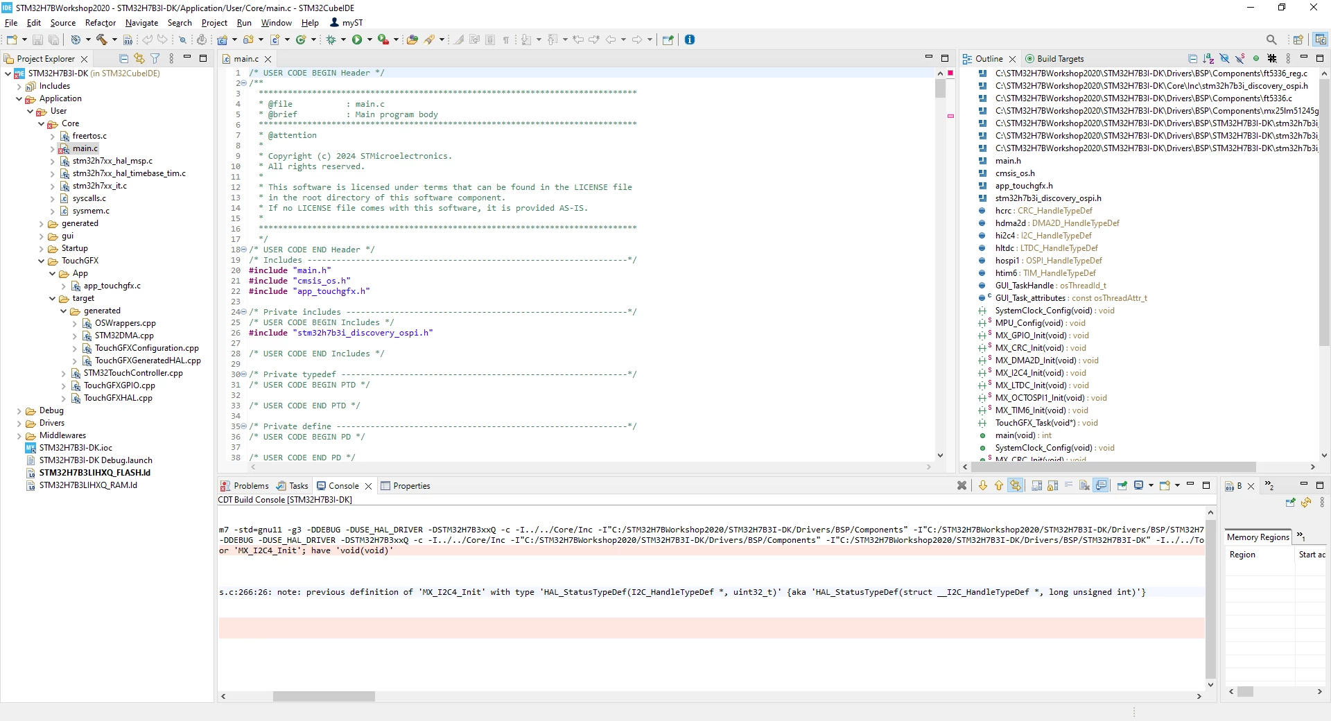

main.c:76:13: error: conflicting types for 'MX_I2C4_Init'; have 'void(void)'
2.
BSP/STM32H7B3I-DK/stm32h7b3i_discovery_bus.c:266:26: note: previous definition of 'MX_I2C4_Init' with type 'HAL_StatusTypeDef(I2C_HandleTypeDef *, uint32_t)' {aka 'HAL_StatusTypeDef(struct __I2C_HandleTypeDef *, long unsigned int)'}
266 | __weak HAL_StatusTypeDef MX_I2C4_Init(I2C_HandleTypeDef *hI2c, uint32_t timing)
Please refer to attached screenshots:
Thank you very much for your attention and support. Please advise at your earliest convenience.

Thank you. Please help!
With best regards
EY1

But having the following new build errors, and do not know what to do:
(Copy from the Console of STM32CubeIDE after build)
In file included from C:/STM32H7BWorkshop2020/STM32H7B3I-DK/Drivers/BSP/STM32H7B3I-DK/stm32h7b3i_discovery_ts.c:51,
                 from <command-line>:
../../Core/Inc/stm32h7b3i_discovery_ts.h:73:37: error: expected unqualified-id before numeric constant
   73 | #define TS_I2C_ADDRESS              0x70U
../../TouchGFX/target/STM32TouchController.hpp:67:27: note: in expansion of macro 'TS_I2C_ADDRESS'
   67 |     static const uint16_t TS_I2C_ADDRESS = ((uint16_t)0x70);
make: *** [Application/User/TouchGFX/target/generated/subdir.mk:32: Application/User/TouchGFX/target/generated/TouchGFXConfiguration.o] Error 1
make: *** Waiting for unfinished jobs....
"make -j2 all" terminated with exit code 2. Build might be incomplete.
14:13:49 Build Failed. 3 errors, 0 warnings. (took 1m:33s.39ms)
(End of Copy from the Console)
Could you please advise what to do?
