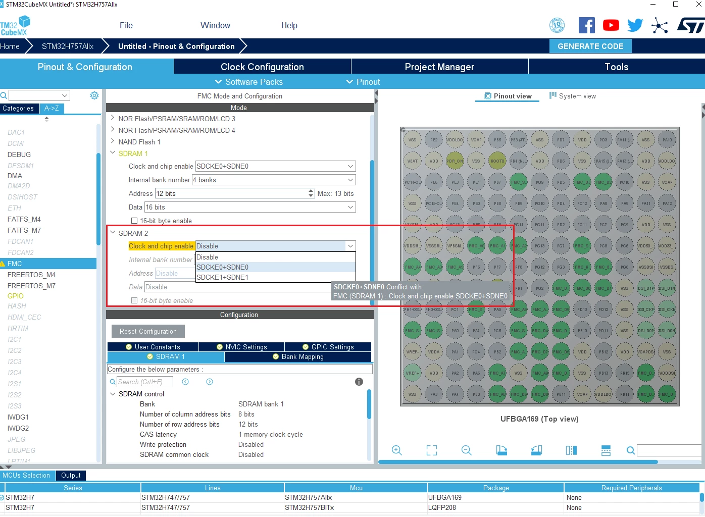

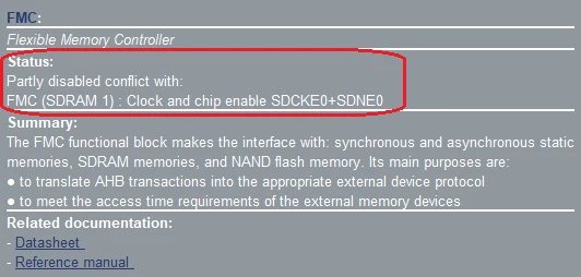

STM32H757 FMC SDRAM1 Warning in CUBEMX.
Dear Friends.
Can someone explain the warning in the picture attached?
If I change the "Clock and chip enable" parameters, the warning keep on.
Best Regards.
Thank you!

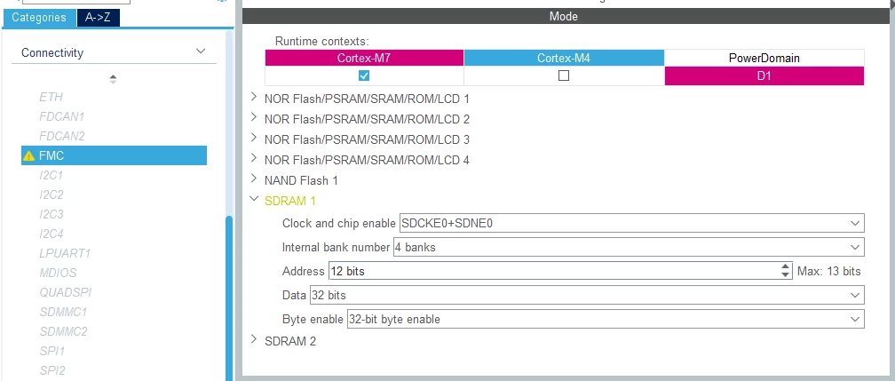

When selecting "SDCKE0+SDNE0" from SDRAM1 > "clock and chip enable " list, "SDCKE0+SDNE0" will be not available for SDRAM2. (Please see attached screenshot).
Regards,
Khouloud.
