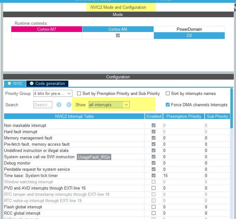

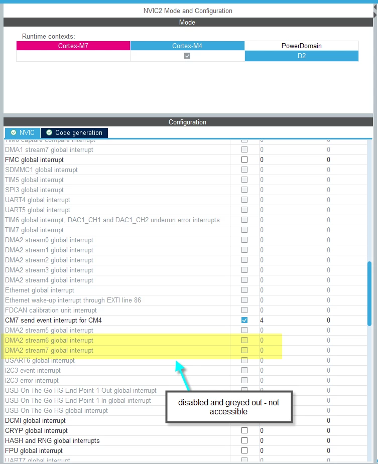

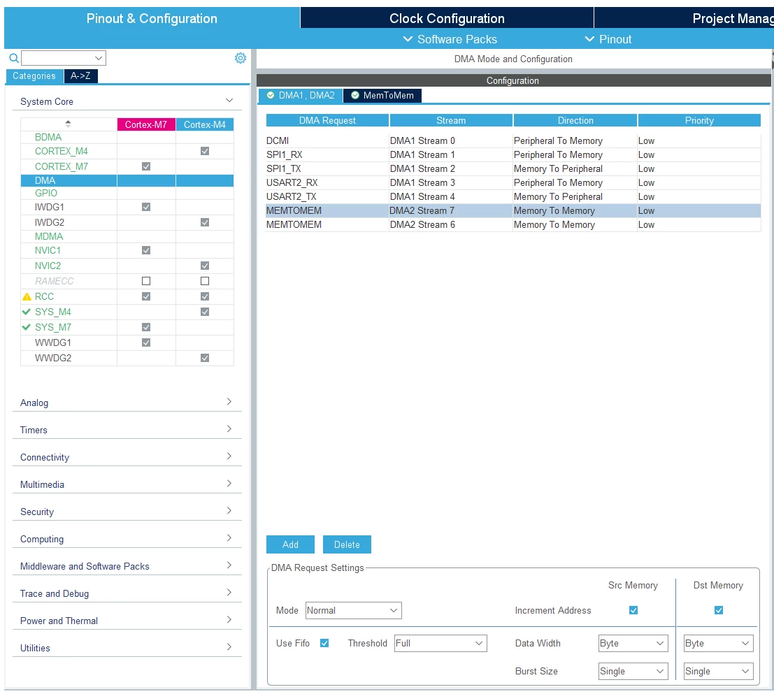

  1. In CubeMX (under System Core -> DMA), I created two M2M channels: DMA2 Stream 6 and DMA2 Stream 7.
  2. I also tested the exact same configuration using DMA1 Stream 6 and DMA1 Stream 7.

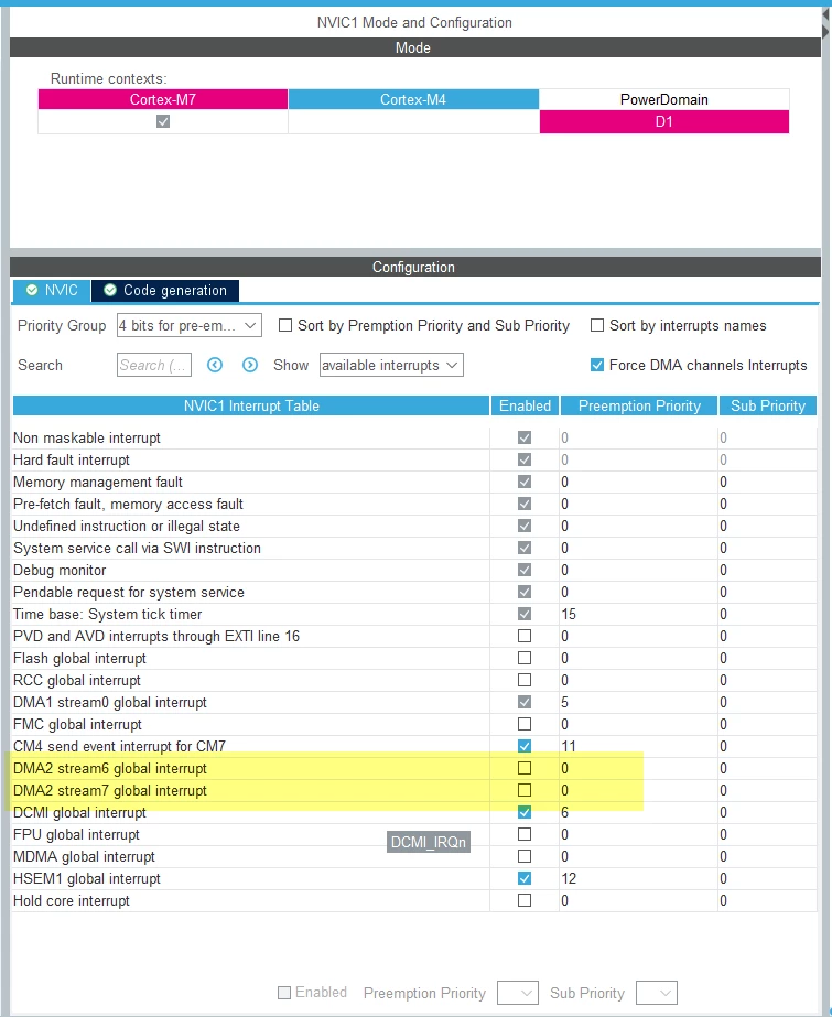

  3. In both cases, when I check the NVIC settings, the Interrupt Request (IRQ) checkboxes and priority settings for these streams are only active under NVIC1 (Cortex-M7). Under NVIC2 (Cortex-M4), the corresponding IRQ checkboxes are completely greyed out and disabled.
Because CubeMX thinks these interrupts belong to NVIC1, it generates the DMA interrupt handlers in stm32h7xx_it.c for the M7 core context instead of the M4 core context.
Currently, I have to manually enable the IRQs via NVIC_EnableIRQ() in code and add the missing IRQHandler functions to the M4 source files manually. However, every time I regenerate code from CubeMX, I have to re-check and clean up the generated files, which is tedious and error-prone.

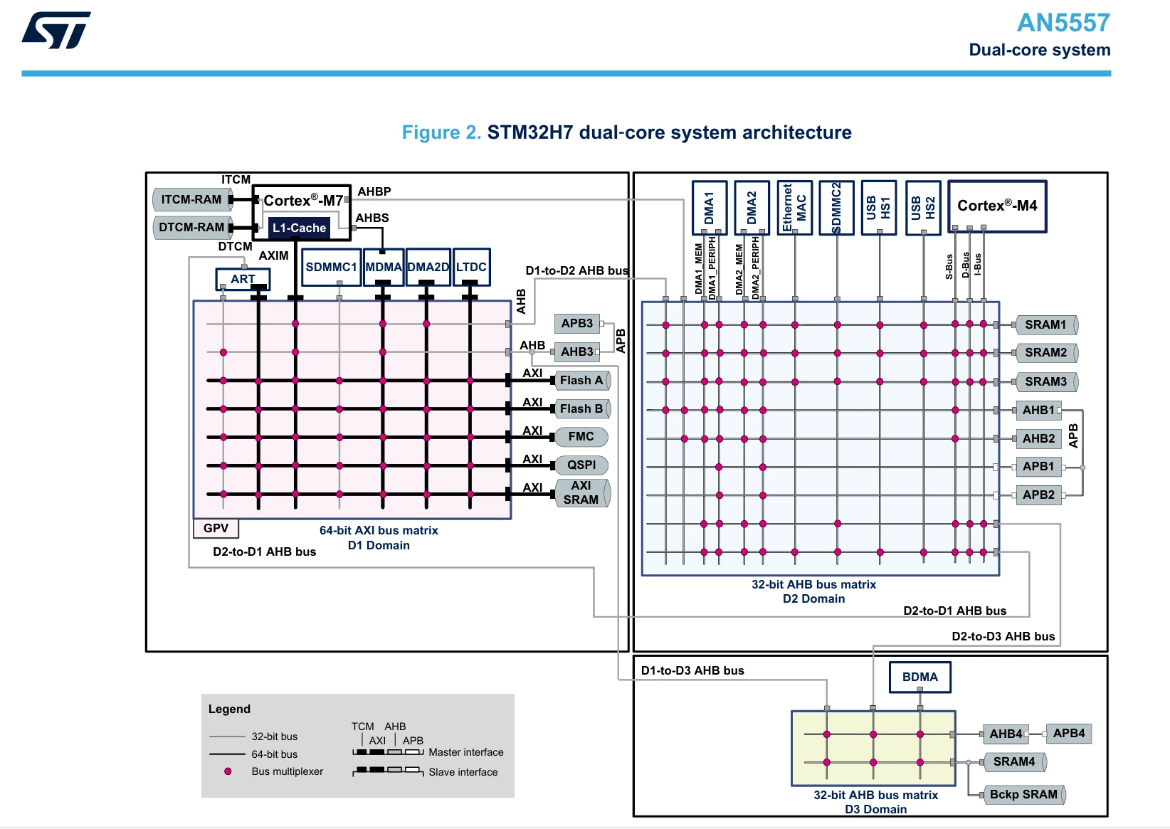

After checking the AN5557
A ticket #0065788 has been escalated to dev team for resolution.
I will keep you posted with updates.
