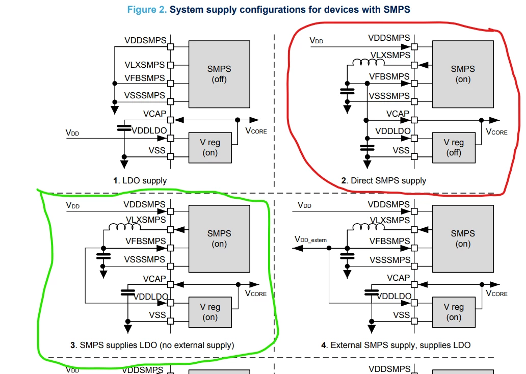

I have been working in a project with the mentioned MCU and by now i have been working it with SMPS_SUPPLY and VOS3 to work at 100Mhz Both CM7 and CM4.
By now days i need to boost it up to 400Mhz and 200Mhz, so i need to change from VOS3 to VOS1 but it is not available in my CUBEMx version 6.8.0 for all types of Supply i only have VOS3 and VOS2.
Not only that issue, if i for example try to use VOS2, i get stuck at:
while(!__HAL_PWR_GET_FLAG(PWR_FLAG_VOSRDY)) {} but when changing back to VOS3, it works fine.
I tryed VOS2 to change from 100Mhz to 150Mhz in both, but got the mentioned issue.

Hello @urbito,
Are you using customized board?  Which oscillator are you using?

hello @FBL yes i am using a customized board with an external oscilator similar to the smt32h745 disco board.

Hello Belaid,
I have found one incongruent configuration due missunderstand between me and hw developer.
my hw have the circuit showed in green and i was configuring the sw to work with the one showed in red ( the stm32h745 dev board).
hope this helps anyone in future.
