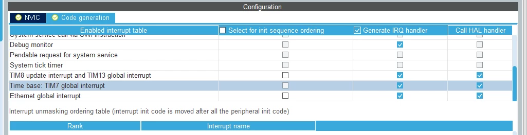

0693W000000VKhMQAW.pngI ran into the same problem (on the STM32H745). For some reason the "Generate IRQ" and "Call HAL function" is unchecked in the code generation. So you either have to add it manually, or have to know to check the code generation option.
I don't see the logic as to why it's turned off, and I wasted a lot of time hunting down the root cause. I hope the default behaviour is changed in future versions.

AShri.1
Apr 6, 2020 2:31 PM UTC
I should have clarified: the code generator sometimes skips generating the isr for SysTick when you eneable -> then disable FreeRTOS. But I've also came across the same issue as you, where the isr for TIM7 (or whatever TIMx is used for SysTick) is not generated. I was able to trace it back to the code generation options.
This is a screenshot of a current project using FreeRTOS and TIM7 as the SysTick.

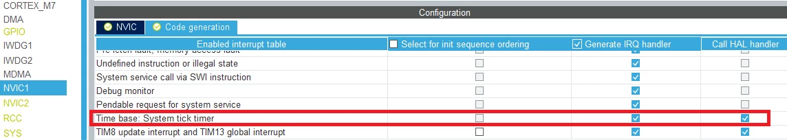

Curtis B.
Curtis B.Author
Apr 6, 2020 6:09 PM UTC
I see, in your project at least TIM 7 is listed in the code generation tab. This is how it looks in my project:
TIM7 does not even appear in the list. Annyways, fixing it manually works. At least I am not the only one with this problem. Thanks for your reply. :)
