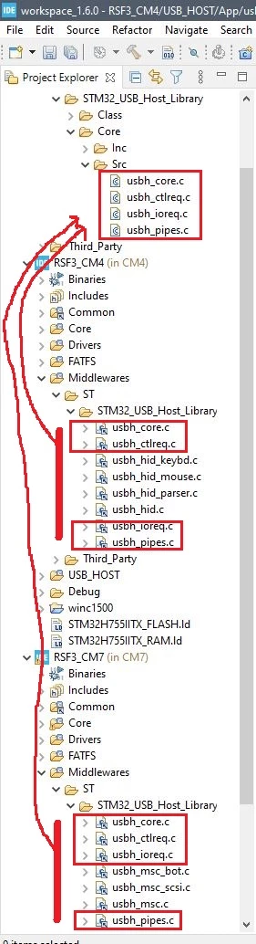

STM32H755 dualcore, I can't start USB_HOST on both cores at the same time
  • April 14, 2021
  • 1 reply
  • 1151 views
0693W000008zX0mQAE.jpgSTM32H755iit STM32H7
STM32CubeMX - STM32 Device Configuration Tool
Version: 6.2.0-RC3 Build: 20210219-1602 (UTC)
STM32Cube FW_H7 V1.9.0
STM32CubeIDE - C/C++ Embedded Development Tools for MCU
Version: 1.6.0.202101291314
When I boot on core CM4 HOST USB HID at the same time and boot on come CM7 HOST USB MSC
, there is a conflict with USBH_StatusTypeDef USBH_Init (..); (usbh_core.c) this is executed twice.
both core link to these Core files.
Is this a bug, or do I have to fix it with an HSEM handler

Hi @Hans T​ ,
Thank you for your question but I m not able to reproduce the issue , can you please send me your ioc?
