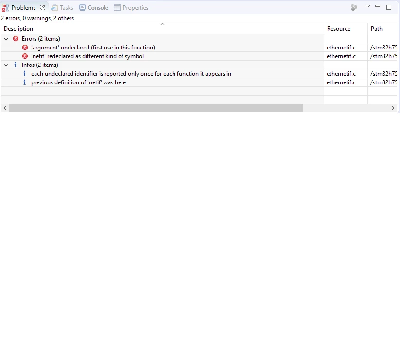

I am trying to reproduce a Lwip project that was done on STM32CubeMX V5, and STM32CUBE FW_H7 V1.7.0.
The project is very simple and consists of ethernet and lwip (httpd). The project works well on FW_H7 V1.7.0, but it does not compile on FW_H7 V1.8.0.
The very same settings does not work on the newer firmware version.
The error type is shown in the photo.
Please help as this is really confusing.
Thank you in advance for your help.
Pavel A.

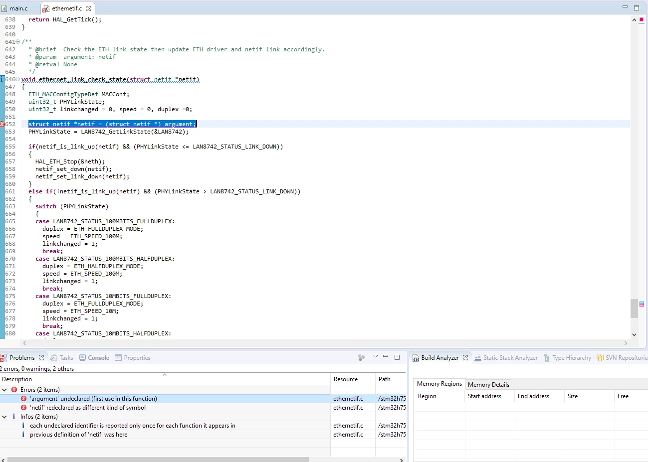

Pavel A.Best answer
Aug 4, 2020 5:12 PM UTC
Remove (comment out) line 652.
-- pa

Pavel A.
Pavel A.Best answer
-- pa

This clearly shows that you must actually learn programming or otherwise you'll not be able to solve even trivial kindergarten level problems. Pavel is right about this particular bug, but take a note that this will not make that bloatware working and on H7 no amount of small fixes can do it.
https://community.st.com/s/question/0D50X0000C6eNNSSQ2/bug-fixes-stm32h7-ethernet
https://community.st.com/s/question/0D50X0000BOtfhnSQB/how-to-make-ethernet-and-lwip-working-on-stm32
