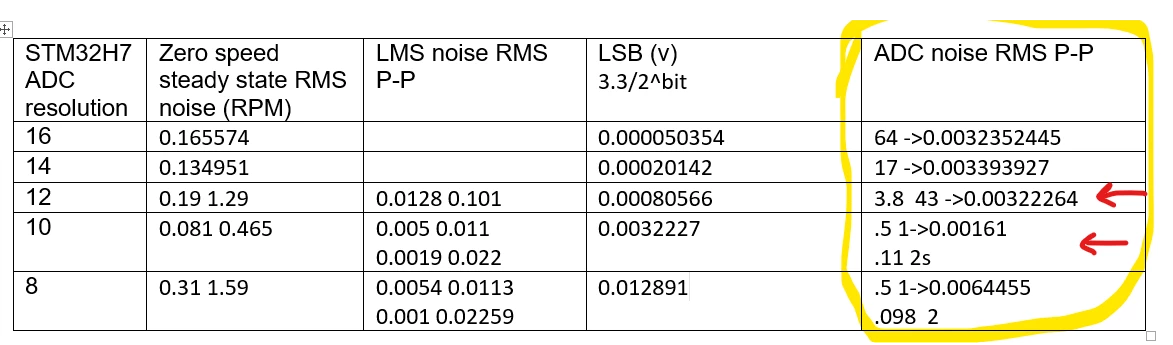

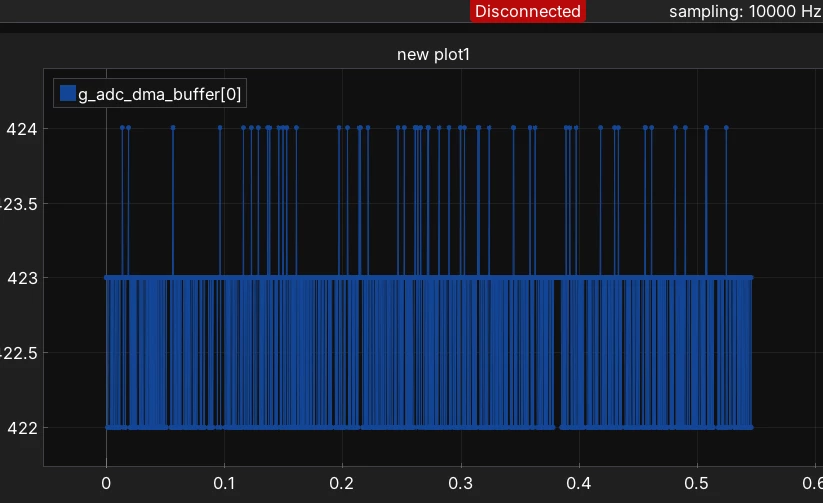

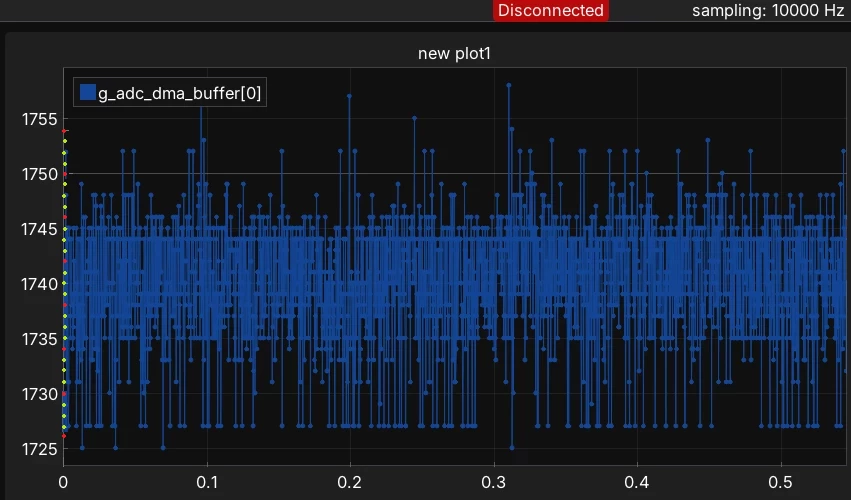

I’ve configured dual channel simultaneous with overrun overwritten and DMA. I’ve connected ECN 1313 incremental signals directly to MCU differential adc. 10ksps, 64.5 ADC sample time, 50MHz ADC clock. The noise on 12bit sampling is more than expected comparing to 10bit. Or in other word noise in 10bit is less than expected compared to 12 14 16!!!
It seems I have more noise than expected in 12 bit data capture, doesn’t it? Also I have attached .ioc. and there the only parameter i am changing manually is the bit depth in main.c manually is “hadc1.Init.Resolution =”.
And here is my statistic calculation:
I think there is something wrong with the hardware! Because 12 bit reading is consistent with 14 and 16 bit depth. It means hardware have more noise on sampling 12 14 16 bit and it seems odd! I havev also checked errata and there was only told if you have ADC_OVR_DATA_OVERWRITTEN;, there would be no problem on DMA and simultaneous dual mode.
