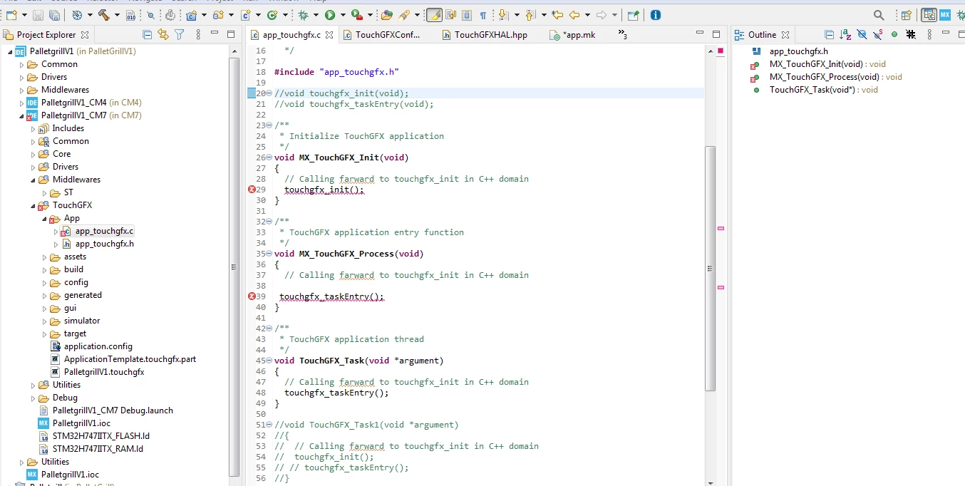

STM32H747IITx undefined reference to `touchgfx_init' its STM32 Cube MX generated code and giving this error.
0693W000007ZXNzQAO.pngI can navigate to that from right click and go to declaration. On converting to C++ it starts to give other issues.

Hello @Community member​
Could you please share your ioc file to check your case?
You're right, issue reproduced and it will be fixed.
Thank you for raising this problem to our attention :)

Same bug here. Here's my notes for the workaround which works great at least until this gets resolved.
Steps needs to be followed in the order below... I've numbered them to help with that.
Step 1: Create a New STM32CubeIDE Project
1) In STM32CubeIDE > File > New > Select Part Number > Next > Set ProjectName > Click Finish
2) Enable SYS > Serial Wire (other configs can be made later)
3) Save and close ProjectName.IOC
4) Build Project (Compiling should be successful!)
Step 2: Add TouchGFX 4.17 to the Project
5) Open ProjectName.IOC > Enable CRC > Software Packs > Select Component > TouchGFX 4.17
6) Expand Software Packs > Enable Graphic Application > *LEAVE ALL TouchGFX SETTINGS TO DEFAULT*
7) Save and close IOC *DO NOT BUILD THE PROJECT *
Step 3: Generate TouchGFX 4.17 Templates
8) Double-click on \TouchGFX\ApplicationTemplate.touchgfx.part
9) Select "Blank UI" > Click red Import button > Click Generate Code > Close Designer using the X
Step 4: Clean & Compile Project
10) Right-click ProjectName > Select "Clean Project"
11) Right-click ProjectName > Select "Build Project" (Compiling should be successful at this stage!)
Step 5: ToughGFX Configurations and Code generation
12) Open ProjectName.IOC > Software Packs > TouchGFX > Set Screen Resolution e.g. 240x240, etc
13) Double-click on \TouchGFX\ApplicationTemplate.touchgfx.part, Click Generate Code > Close Designer using the X
14) Right-click ProjectName > Select "Clean Project"
15) Right-click ProjectName > Select "Build Project" (Compiling should be successful at this stage!)
done!
Note: If Partial Buffer is required and selected in the TouchGFX configs:
16) Move attached "TouchGFX_DataTransfer.h" and "TouchGFX_DataTransfer.c" into the \TouchGFX\target\ folder
17) CLEAN PROJECT and Build Project

Have you tested this method? I did step by step many times. but in step 11 still I have same problem..
Mecanix
Sep 15, 2021 11:46 PM UTC
Hi. You are correct. Well, half-correct rather! You had me doubting and so I've tried those steps to find out it does not work for every parts. For instance the built failed for a STM32F412RGT6 however it did worked perfectly fine for a STM32H743VIT6.
I'm attaching the successful built (STM32H743VIT6) following the steps above. I've cleaned the project, see if you can build it.
ps. For the record; the STM32F412RGT6 failed build I'm getting the following errors:
1) undefined reference to `touchgfx_init'
2) undefined reference to `touchgfx_taskEntry'
