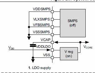

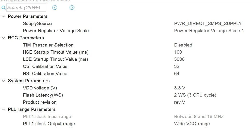

You need to change power configuration according to hardware arrangements ( 1 SPMS only , 2 LDO only , 3 SPMS - LDO cascaded , 4 External power supply ) for reference check the STM32H745NUCLEO  schematic. Their they mush have given details about all the power configurations.
Also you need to make following changes in your code at function .
void SystemClock_Config(void)
 RCC_PeriphCLKInitTypeDef PeriphClkInitStruct = {0};
 /** Supply configuration update enable
 HAL_PWREx_ConfigSupply ( PWR_LDO_SUPPLY );
/********* change the parameter as per your power configuration , goto PWR_LDO_SUPPLY macro defination , there you will find macros other combination , select relevant one *****************/
 __HAL_PWR_VOLTAGESCALING_CONFIG(PWR_REGULATOR_VOLTAGE_SCALE1);
 while(!__HAL_PWR_GET_FLAG(PWR_FLAG_VOSRDY)) {}
 /** Macro to configure the PLL clock source
 __HAL_RCC_PLL_PLLSOURCE_CONFIG(RCC_PLLSOURCE_HSI);
connect your board to your PC, put the controller into debug mode, add break point after init done and test the code.
Note : if it still got stuck in waiting for voltage level to set, simply unplugged the cable, make sure no failure occurred into popped folder window for controller. put the controller in debug and hit the RUN . This worked for me.
kaspars.laizans
June 2, 2022
Thanks. I have a board with external 3v3 supply tied to all the power pins and same behavior - won't start up in standalone, debug sessions would work if started up into system bootloader (pulling boot0 to 3v3).
What is strange - debug connection works even with PSU configured with SMPS if you comment out the check for VOSRDY. I would expect it to fail, since SMPS output messes with the rest of the power bus, but I guess it's an impedance thing. Didn't actually measure.
Setting source to LDO and scaling to 0 helped.

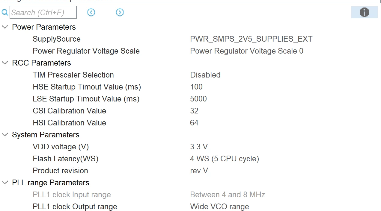

I have essentially the same issue on a STM32H7A3.
  1. __HAL_PWR_VOLTAGESCALING_CONFIG(PWR_REGULATOR_VOLTAGE_SCALE0);
  2. while(!__HAL_PWR_GET_FLAG(PWR_FLAG_VOSRDY)) {} // <--- FREEZES HERE
The strange thing is that the problem occurs sometimes.
While sometime the device works properly. Even for long period, let's say
the board can work properly for some week.
I supposed it can be tied to the power supply but I can't see
any issue in the design. By the way I'm using LDO supply configuration
providing a regulated 3.3V to the device.
0693W00000GZQnwQAH.jpgI've checked the configuration and is all connected as suggested by the
manual.
Did someone managed to understand the origin of this issue?
O'li
February 9, 2023
I'm facing a similar issue on STM32H745: on rare occasions the chip gets stuck on the VOSRDY check, and the only way to get it back on track is the BOOT0 / Reset power cycle.
Does someone have further insight on this topic?

Same problem here with a STM32H743. I'm trying this:
void power_init()
    // Enable SYSCFG peripheral clock
    uint32_t apb4enr = RCC->APB4ENR;
    RCC->APB4ENR |= RCC_APB4ENR_SYSCFGEN;
    // Enter VOS1 mode (required before entering VOS0 mode)
    PWR->D3CR |= PWR_D3CR_VOS_Msk;
    while (!(PWR->D3CR & PWR_D3CR_VOSRDY));
    // Enter VOS0 mode;
    SYSCFG->PWRCR |= SYSCFG_PWRCR_ODEN;
    // Restore previous RCC APB4 clock register state
    RCC->APB4ENR = apb4enr;
and it gets stuck on the first VOSRDY loop
