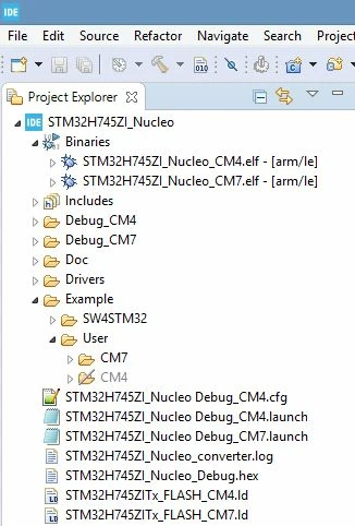

can you tell me the behaviour on your machine? I have imported several projects from the SW_Fimware-package for STM32H7 for further tests, but everytime the CM4 folder is greyed out/excluded from build. I have read the instructions carefully within the ST documentation, but in the end I don't know if I didn't catch a hidden point.
This is my STM32CubeID version:
STM32CubeIDE
Version: 1.4.2
Build: 7643_20200813_1322 (UTC)
OS: Windows 8.1, v.6.3, x86_64 / win32
Java version: 1.8.0_252
I have tested this on a Win7 machine as well with the same results.
This is how it looks like when I create a new workspace and import the project and run the build. Both elf files are generated but always taking into account that the CM4 folder is greyed out / excluded from build. The CM4 folder is greyed out even before I start the compilation.
Somehow this approach looks strange compared to the manuals which are provided by ST.
How can I fix this issue?
September 12, 2020
Here's what I did:
  • Open the .project file within the SW4STM32 directory.
  • STM32CubeIDE will launch and want to convert the project to the right format for this IDE. Let it do so (click OK, then Finish)
  • Right click the project and hit Build. It will build both the CM4 and CM7 projects.
The first two steps can also be done by File -> Open projects from file system and selecting the directory with the .project file.
My screen look similar to yours. CM4 is grayed out because it is excluded from the Debug_CM7 build configuration.
I doubt Win7 or Win8 will affect things here.
