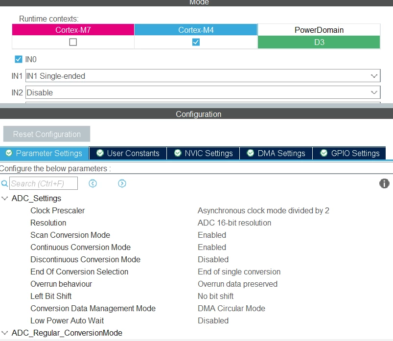

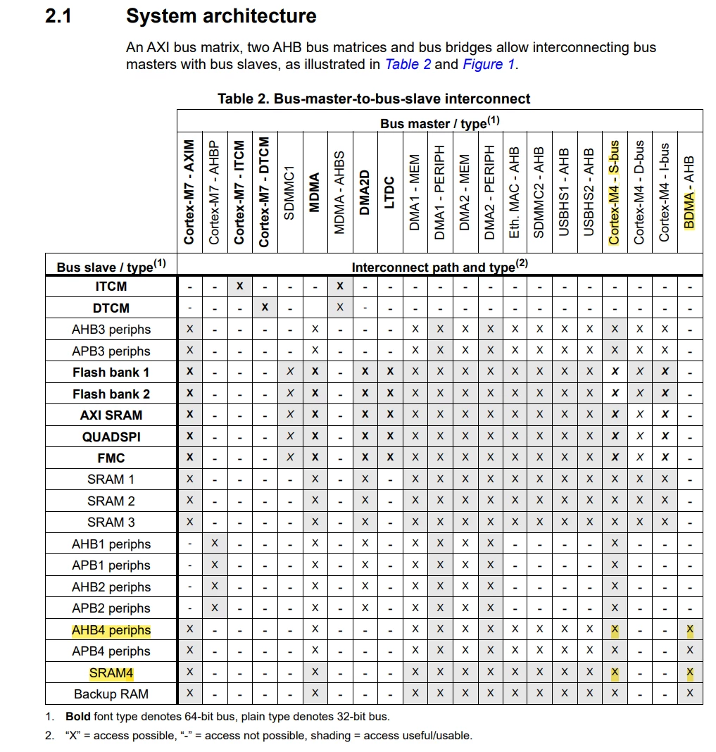

STM32h745 ADC+DMA in cortex M4 continuous in Busy state

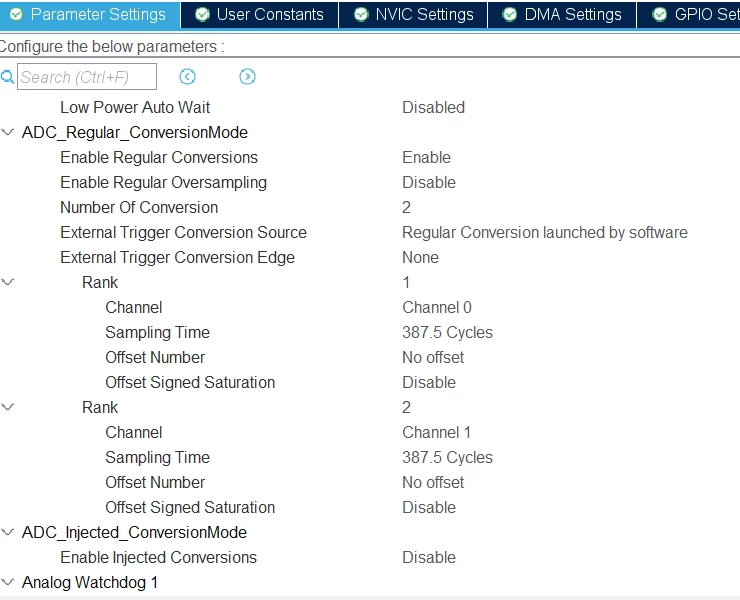

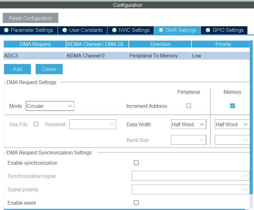

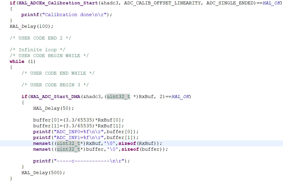

I am working on STM32h745 controller. In cortex M4 I enable two ADC3 channels. Read the ADC value using DMA method. Only one time I get the ADC value after that it shows busy. Also I changes the sampling time, but no effect. But that ADC3 channels properly work in cortex M7 using DMA method.
0693W00000aHoFdQAK.png0693W00000aHoFsQAK.png0693W00000aHoGMQA0.png0693W00000aHoFxQAK.png0693W00000aHoGRQA0.png0693W00000aHo4dQAC.pngCan you please help me.

Based on your configuration, you need to configure SRAM4 to store peripheral input/output data in D3 domain.

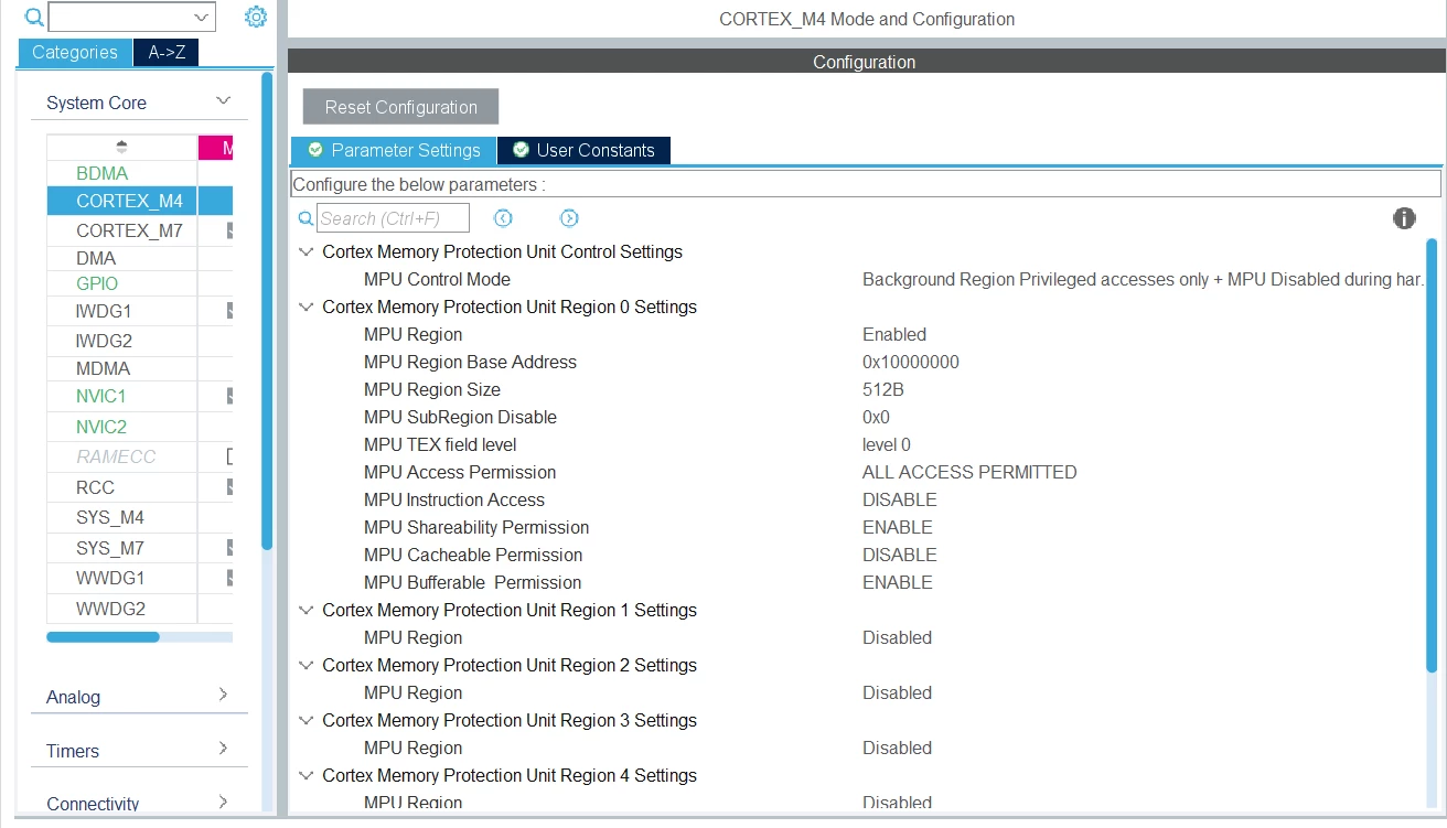

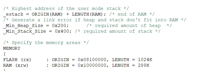

But how I can store in SRAM4, in Cortex M4 in flash.ld there is only one RAM
Mar 1, 2023 4:06 PM UTC
According to the reference manual, SRAM4 is the only RAM accessible by BDMA and ADC3.
0693W00000aHxdPQAS.pngI guess the linker for FLASH CM4 in IAR is correct. I will check the missing memory area in CM4 and get back to soon.
