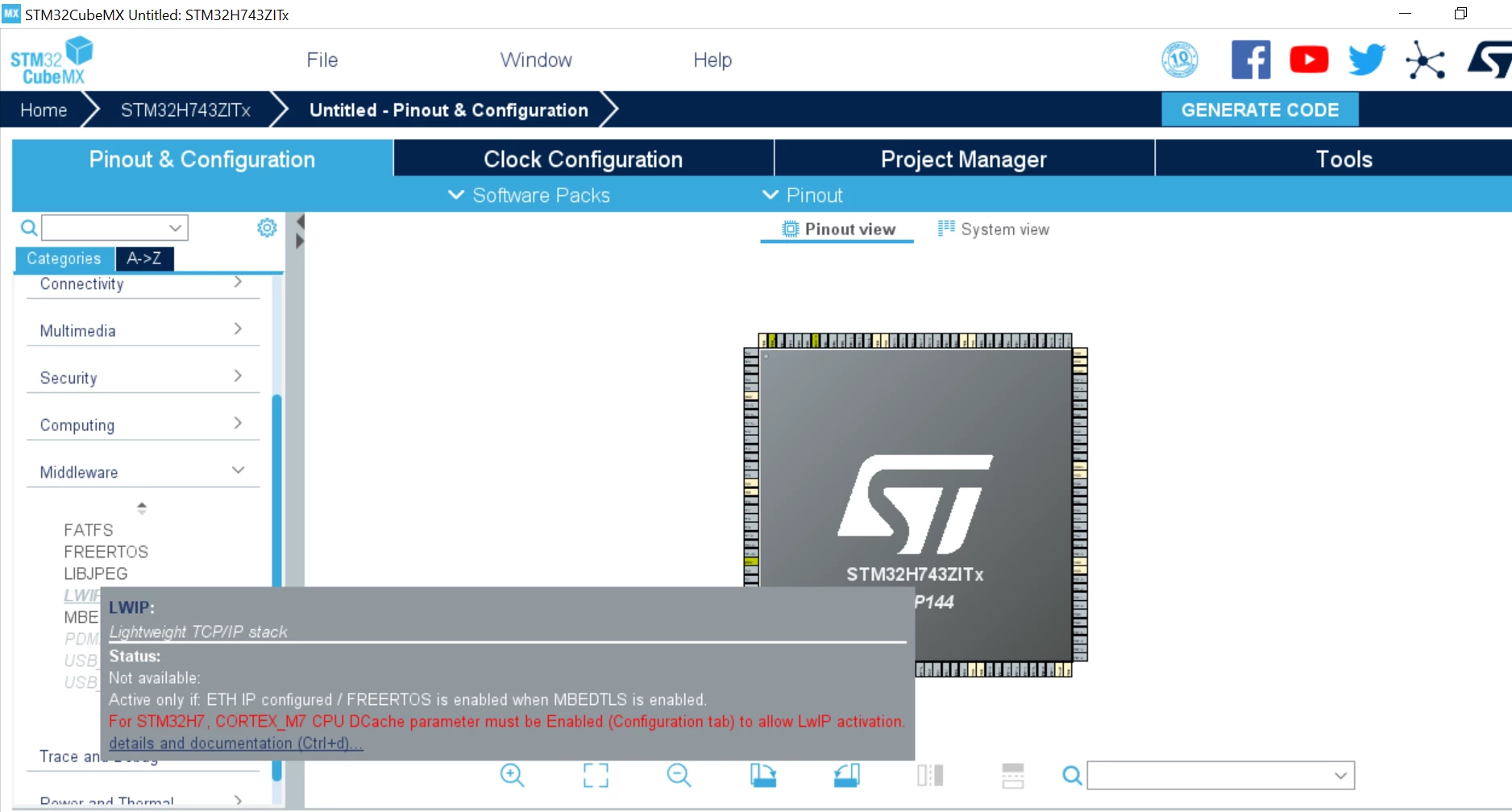

STM32H743ZIT6U LWIP issue
Hi
I'm currently using STM32CubeMX for STM32H743ZITx.
However, I can't enable LWIP function. (Categories -> Middleware -> LWIP)
Previously on STM32F429, I could use LWIP, but I can't even enable the function on this series.
Can anybody help me with this?
Thank you in advance.
Khouloud ZEMMELI
Khouloud ZEMMELIBest answer
Nov 6, 2020 7:12 AM UTC
Hello @SHong.5​ ,
For H7 series , in addition to ETH , you need to Enable the CPU DCache under system core - Cortex_M7 (for your case) so that LWIP becomes available be enabled.
0693W000005AYOMQA4.pngBest Regards,
Khouloud

SHong.5
SHong.5Author
Nov 6, 2020 7:24 AM UTC
Hello Khouloud
Thank you very much. I have solved LWIP issue from above solution.
However, I can't go further with compiling the code.
FILE : ethernetif.c
CODE(line 652) : struct netif *netif = (struct netif *) argument
ERROR : 'netif' redeclared as different kind of symbol
Could you help me with this please?
Khouloud ZEMMELI
Nov 6, 2020 7:29 AM UTC
Yes @SHong.5​ , it's a known issue , now fixed and the fix will be available for the next CubeMX release (6.1.0) which will be available on site W48.
You're always welcome.
Khouloud
