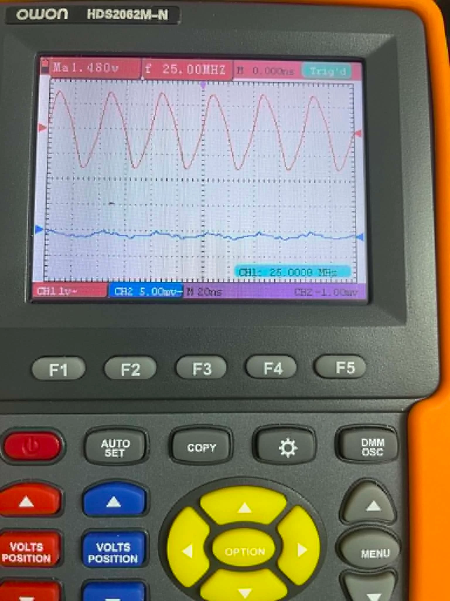

I’m try to handle my Thesis project. With ETH block, when i download program to STM32H732Z nucleo kit, it can Pìn IP correctly. But when i download to my custom board, it fail to Pin IP, i compare schematic with STM32H732Z nucleo kit→ it same. right now i supplt 25Mhz from NB3L553DG( page 1, oscillator block),  reset Pin use deafault( just have 1 pull-up resistor). 2 indicator led( green, and yellow) still blink. On RJ45 connector: The orange led is on, the green led flashes at first then stays on.

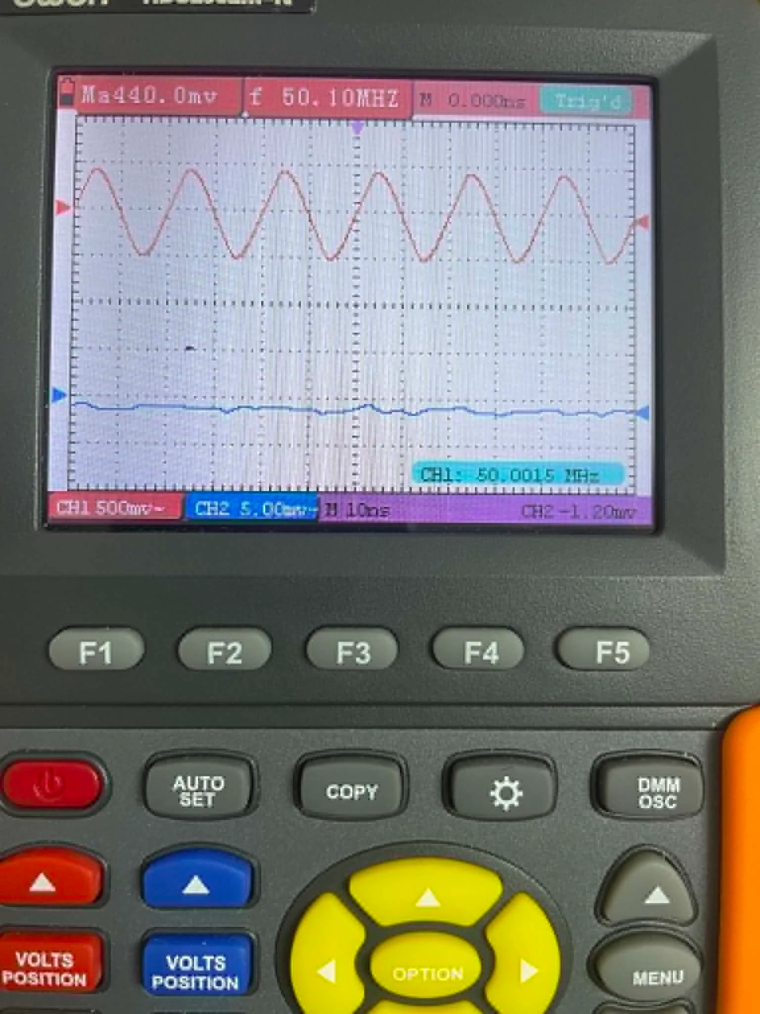

  1. signal REF_Clock to pin PA1: 50Mhz,

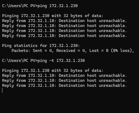

i update picture of IP ping result, and clock supply for X1 of LAN8742A, REF_CLOCK to Pin PA1 of STM32H7

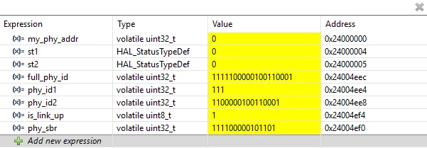

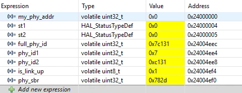

i update: read PHY → OK, ID=0, read PHY status→ OK as Picture. but still can’t Ping IP

Logically, if the code works on the nucleo and not on your board, then there is a difference in hardware, yes? Changing the code won’t fix that. You should look for the hardware differences and let that guide your decision. If you can’t find any, keep looking. That is (or should be) part of tedious university research. I’ve been there. There is an answer and it is your job to find it.
If you are stuck, debug your code to find out what isn’t happening correctly relative to the working hardware.
