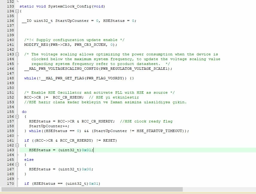

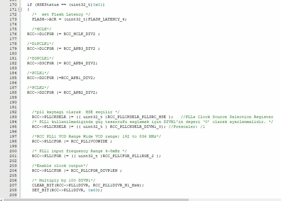

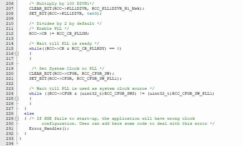

Hi, I use stm32h743zi nucleo board.I did clock configuration for stm32h7 with cubemx ,but I want to write clock configuration without hal library with registers.
My clock configuration codes in attachment.
Is there anyone who can tell me where is the mistake ?
Ok, and what's stopping you from debugging this, or comparing and contrasting what you're achieving against the working HAL code?
There is a specific code pasting option here, use the </> icon in the input window not attach screen shots of uncompilable code.
