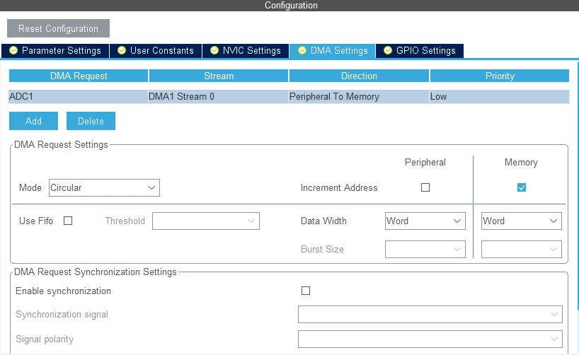

STM32H743ZI I was trying to read multiple channels from ADC1 and ADC3. Using polling method i am able to get the values but when I try using DMA(HAL_ADC_Start_DMA(&hadc1,(uint32_t*) adc,6);) I am not getting any values.
  • February 10, 2020
  • 1239 views
In community they have asked to disable D cache (https://community.st.com/s/article/FAQ-DMA-is-not-working-on-STM32H7-devices). How to disable D cache globally. I made the necessary changes in the linker script. I am using system workbench for stm and stm32cubeMX.
DMA stream0 for adc1 6 channels.
DMA stream1 for adc3.

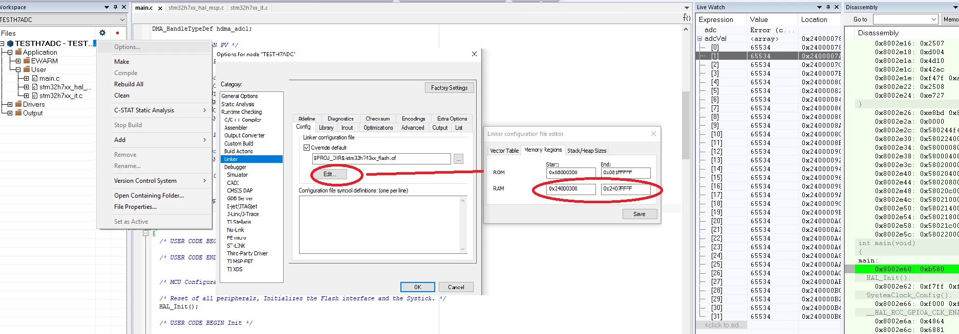

0693W0000000EBCQA2.pngHello,
I have made a test to check and I don’t have any problem to read the values for ADC1 (DMA stream 0)
You should change the memory address, as shown in Figure (when using IAR)
Please see the RM0433 Rev 6 (page 101, 128) for more clarification
