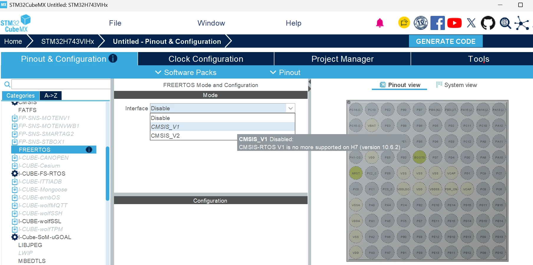

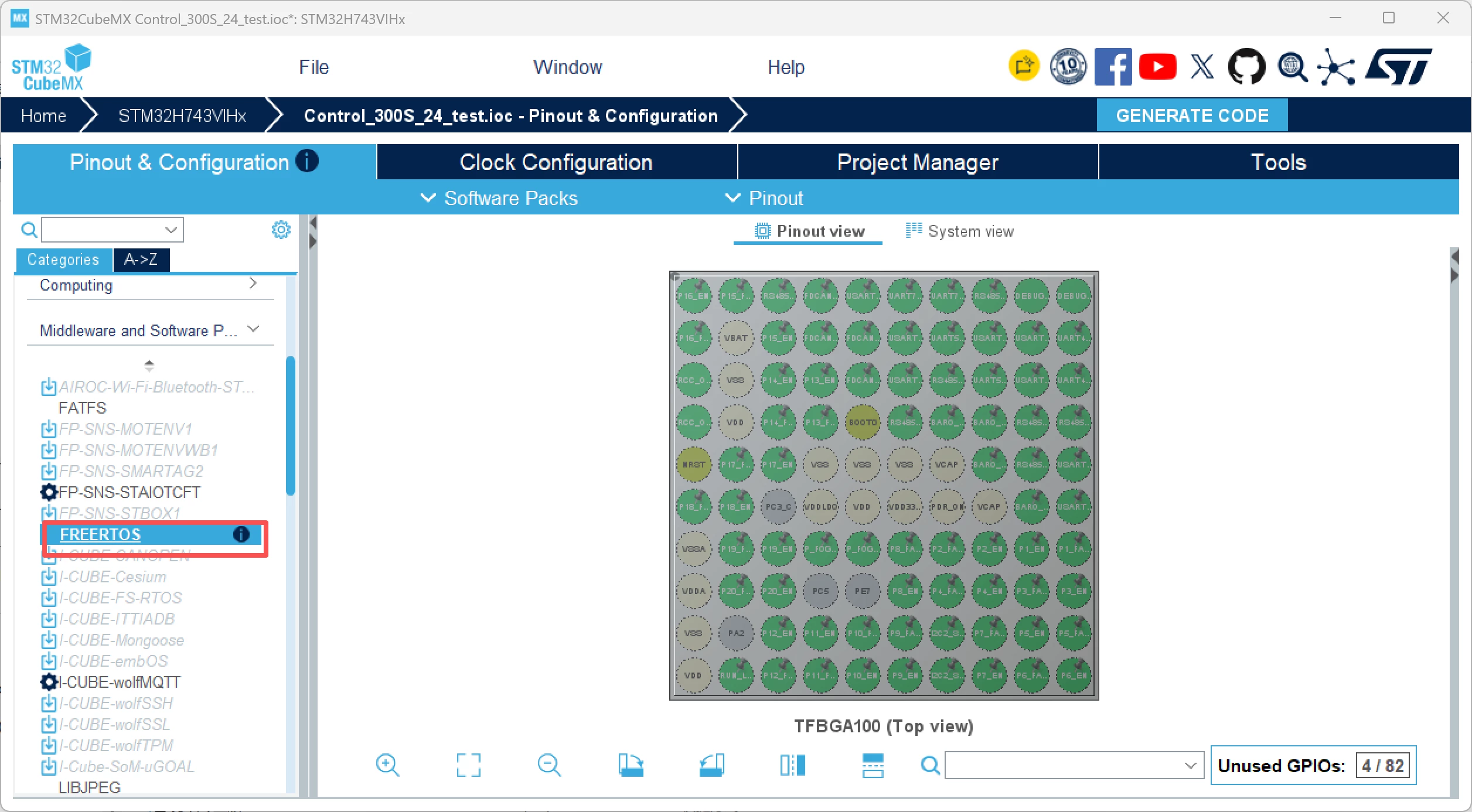

Figure 1 shows the project after automatic migration from STM32CubeMX 6.16 to 6.18.x.
In this migrated project:
  • The FreeRTOS configuration option cannot be opened.
  • The FreeRTOS settings are missing.
  • After generating the code, all FreeRTOS-related source code is automatically removed.

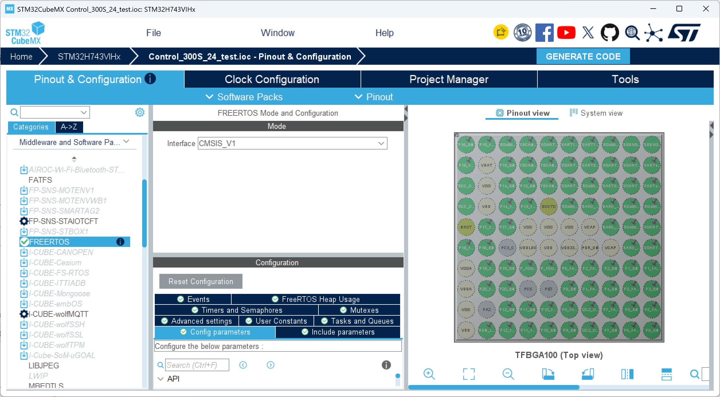

Figure 2 shows the same project opened using the compatibility mode.
In compatibility mode:
  • The FreeRTOS configuration page can be opened normally.
  • The original FreeRTOS settings are retained.
  • The project can generate FreeRTOS-related code correctly.

Aug 4, 2026 6:58 AM UTC
Hello ​@ZERO153759
Let me thank you for posting.
CMSIS- Rtos V1 is no more supported on H7.
Thanks.
Mahmoud
2 replies
Hello ​@ZERO153759
Thanks.
Mahmoud
Aug 25, 2026 3:17 AM UTC
Thank you very much for your reply.
When I open the project with the old version compatibility mode instead of migrating it, the project can still use FreeRTOS V1 normally. Why do older STM32H7 development tool versions support FreeRTOS V1, while the latest versions no longer support it? Furthermore, why does the IDE freeze or crash when opening the migrated project?
If I want to use the latest version of the software, are my only choices to open the project in old-version compatibility mode or to create a new project and rewrite the development code?
Most of the application functions were implemented based on the FreeRTOS configuration. Does migrating to the new FreeRTOS version mean that the entire project needs to be rewritten? This would be a significant amount of work.
