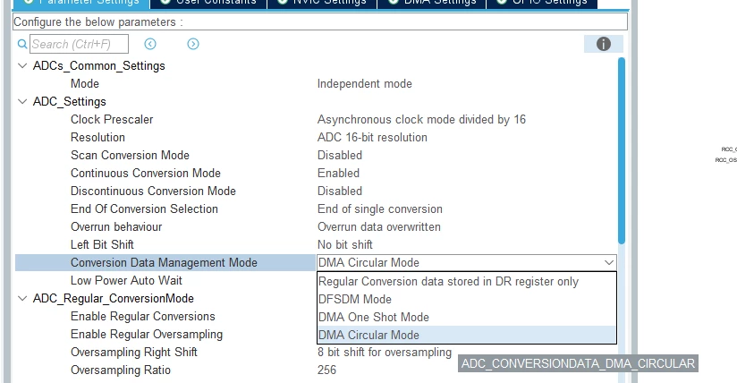

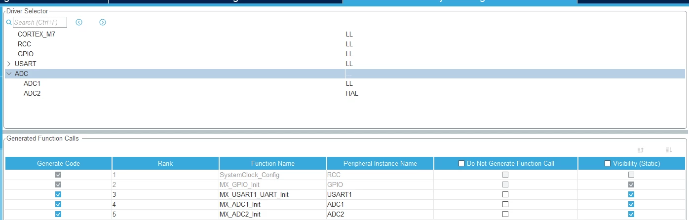

I found that the ADC sample is wrong when I use LL library, and it is correct when using HAL library.
By comparing the registers, I found the code generated for LL library missing a sentence;
LL_ADC_SetChannelPreSelection(ADC1, LL_ADC_CHANNEL_19);
And when I config the ADC using DMA to transfer, it doesn't work;
I added the following code manually, and it works.
LL_ADC_REG_SetDataTransferMode(ADC1, LL_ADC_REG_DMA_TRANSFER_UNLIMITED);
 I configure the VREFBUF to use externel reference, but this seems generate nothing.
LL_APB4_GRP1_EnableClock(LL_APB4_GRP1_PERIPH_VREF);
SET_BIT(VREFBUF->CSR, VREFBUF_CSR_HIZ);
Can these bugs get fix?

Hello @Windmill_City
Concerning the missing line of code
Actually , this is a known issue has been tracked by the Ticket 189311 and will be fixed asap.
Concerning the VREFBUF issue , after checking the stm32h7xx_hal_msp.c : the generated code is correct , VREF clock is enabled and
is done inside the call
 HAL_SYSCFG_VREFBUF_HighImpedanceConfig(SYSCFG_VREFBUF_HIGH_IMPEDANCE_ENABLE);
void HAL_MspInit(void)
 /* USER CODE BEGIN MspInit 0 */
 /* USER CODE END MspInit 0 */
 __HAL_RCC_SYSCFG_CLK_ENABLE();
 /* System interrupt init*/
 /** Enable the VREF clock
 __HAL_RCC_VREF_CLK_ENABLE();
 /** Disable the Internal Voltage Reference buffer
 HAL_SYSCFG_DisableVREFBUF();
 /** Configure the internal voltage reference buffer high impedance mode
 /* USER CODE BEGIN MspInit 1 */
 /* USER CODE END MspInit 1 */
Concerning the other issue of missing code
a ticket  197360  has been raised to dev team for fix
THX
