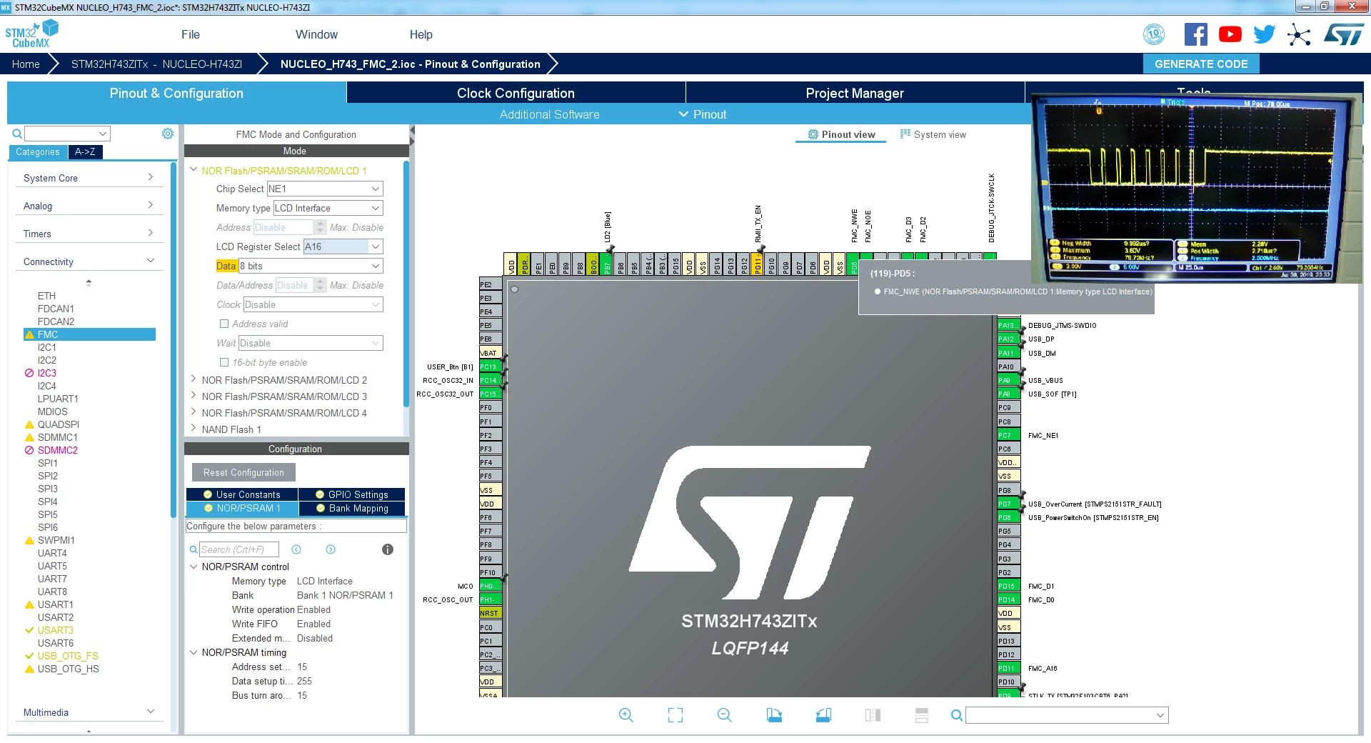

I have just changed from STM32F (works fine) to STM32H and have used MX to generate the Code for a SRAM 16 bits wide and 6 Address lines. The FMC outputs the NE clock but depending on the Data Bus Setting 8, 16, or 32, NE produces either 8, 4, or 2 Clocks respectively within the NE Clock, the Address also increments for each down clock within the NE. My reqiuirements are for a single NE Clock for a 16 Data Bus. It appears that the FMC always wants to clock a 64 bit word what ever the Data Bus size. Regards JohnW

waclawek.jan
July 12, 2019
From RM0433, FMC chapter, Supported memories and transactions
General transaction rules:
The memory region MPU attribute must be configured as “Device�? or “strongly-ordered�?
in order to prevent issues on devices that do not have the byte select feature. As an
example, if byte accesses are performed to 16-bit memories with the MPU attribute set
to “Normal memory�?, the AXI transaction size is 64 bits and the FMC splits the
transaction into four consecutive accesses while only one access is expected instead
of four.
I don't use 'H7.
john239955_st
July 12, 2019
Thanks Jan ... That explains why I have 4 Write clocks within the NE1 ... I was at the point of going back to the STM32F427.
I may need to check out the attribute. Do you know if it changed in the Compiler/MXCube.
Thanks for the information KR ... JAW

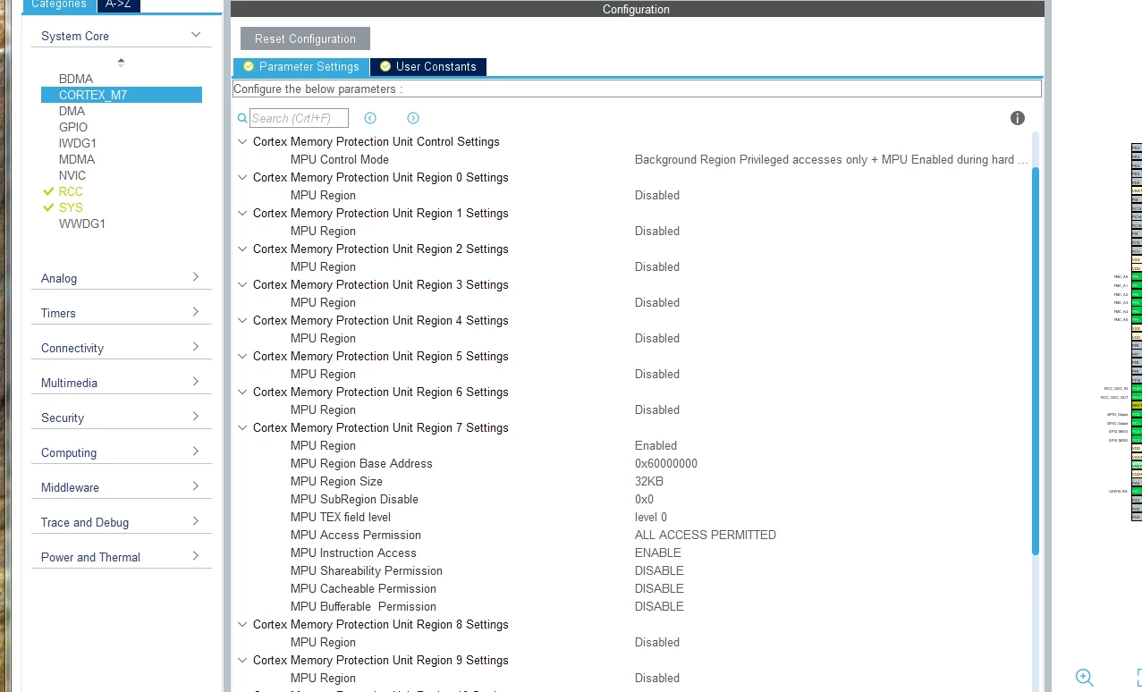

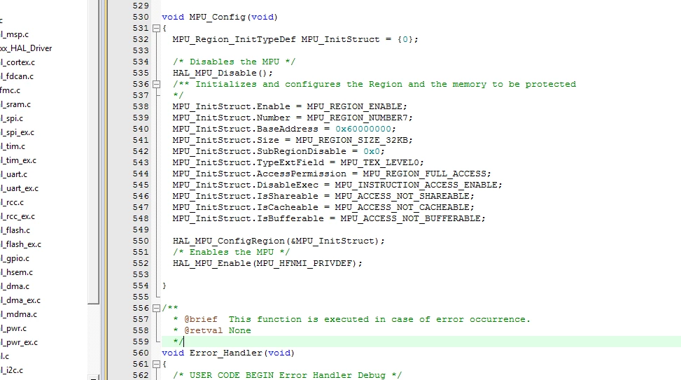

john239955_st
July 31, 2019
Hi Amilton ... Yes had local FAE give some help.
The Memory has to be put into a Region this can be done from CubeMX, I made sure CubeMX was updated.
Only had this working yesterday so have not fully checked out
KR John W
Trevor Jones
Senior
September 3, 2019
Yep it fixed my issue, thanks for that...
