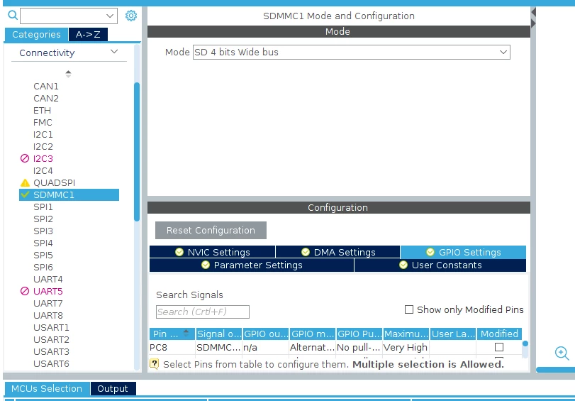

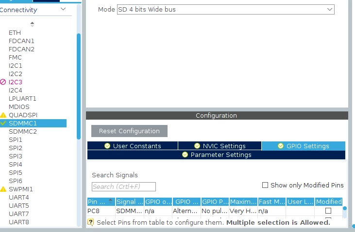

I'm attempting to use the SDMMC with an SD card, and with DMA. However, when I use the STM32CubeMX IDE, there is no option to enable or use the DMA.
Using: STM32CubeMX version 5.3.0
Here's the configuration for SDMMC1 on the STM32H743
And here it is for SDMMC1on the STM32F7
Notice that there is no DMA configuration option for the H7, but there is for the F7.
Does this mean that ST doesn't have DMA based drivers on the H7? With the polling drivers, my performance is extremely slow -- something like 0.2MB/sec.

My reading of the stm32h7 reference manual suggests that the SDMMC module has its own built-in DMA controller IDMA.
You can't use DMA1 or DMA2 so there's a lot less to configure.
(I think you can use the MDMA for SDMMC DMA).
Now how much of this is brought out to stm32Cube is down to ST. You might have to write your own code to use the SDMMC IDMA.
(My main use of STM32Cube is to explore how I might distribute my required peripherals amongst the ones present on a microcontroller, as there are a lot of shared pins and DMA channels/streams. I tend not to use its code-generation ability.)

Hi. "The SDMMC host interface embeds a dedicated DMA controller allowing high-speed transfers between the interface and the SRAM." - from STM32H743 datasheet.
You can use HAL_SD_ReadBlocks_DMA and HAL_SD_WriteBlocks_DMA functions (they just start DMA transfer). And you must wait for transactions. Check HAL_SD_TxCpltCallback or HAL_SD_RxCpltCallback.
