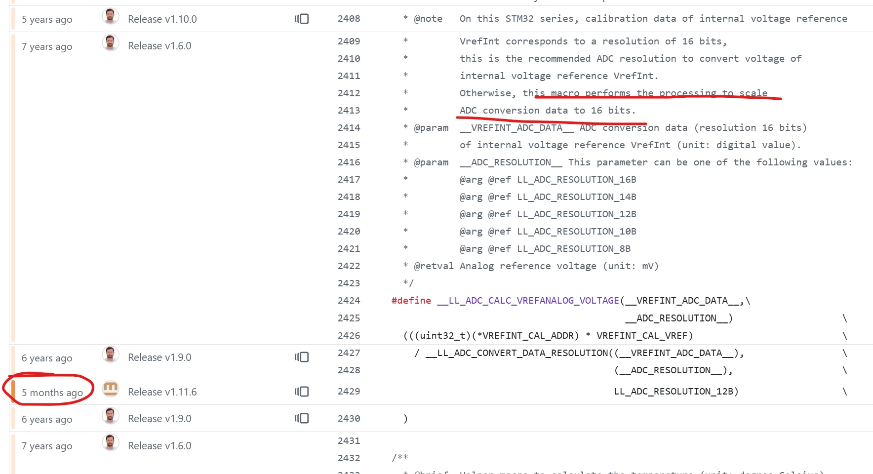

ifemcAuthor
Jul 28, 2026 8:49 AM UTC
I narrowed down to the line of code that broke the internal temperature sensor.
File:
Drivers\STM32H7xx_HAL_Driver\Inc\stm32h7xx_ll_adc.h
Line 2429 from STM32CubeMX 6.14 (working):
#define __LL_ADC_CALC_VREFANALOG_VOLTAGE(__VREFINT_ADC_DATA__,\
__ADC_RESOLUTION__) \
(((uint32_t)(*VREFINT_CAL_ADDR) * VREFINT_CAL_VREF) \
/ __LL_ADC_CONVERT_DATA_RESOLUTION((__VREFINT_ADC_DATA__), \
(__ADC_RESOLUTION__), \
LL_ADC_RESOLUTION_16B) \
Line 2429 from STM32CubeMX 6.18 (not working):
LL_ADC_RESOLUTION_12B) \
The difference is that LL_ADC_RESOLUTION_16B was changed to LL_ADC_RESOLUTION_12B.
TDKBest answer
Jul 28, 2026 9:58 PM UTC
They did fix the error on the H723 but in the process ended up breaking it for the more common H743. Points for trying?
Is there a typo in temperature and VREF Analog conversion macros defined for STM32H723 HAL? | Community
Incorrect calculation of __LL_ADC_CALC_VREFANALOG_VOLTAGE on STM32H723 | Community
Macro comments are now incorrect as it scales the value to 12 bits, not 16.
Very sloppy. Changing it 100% breaks any code that used it before.
I may be missing something but treating the cal value as 12 bit or 16 bits needs to be processor dependent, and this macro clearly is not written to handle that correctly.
