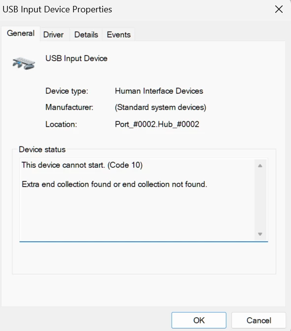

I am trying to test a CustomHID from the STMCubeMX code and the project does not seem to work as intended.
When I use the HID Standalone example for the STMH735G Dev Kit the project works as intended however when I try to set it up with the CustomHID windows gives this error. I changed the clocks to match the HID Standalone project with a max clock of 520mhz.
Wondering what I am doing wrong or if there is some setting that needs to be modified for this to work properly. Looks like everything is setup and should work already but doesn't

Hello @Community member​,
Check the differences in Clock Configuration between the -ready to use- application and your project created with CubeMx.
Have a look at this FAQ: USB device not recognized.

Hi Imen,
The clocks are identical to the ready to use application and my application.
I increased the heap size to 0x1000 as suggested and this still did not resolve the issue.
still receive code error 10

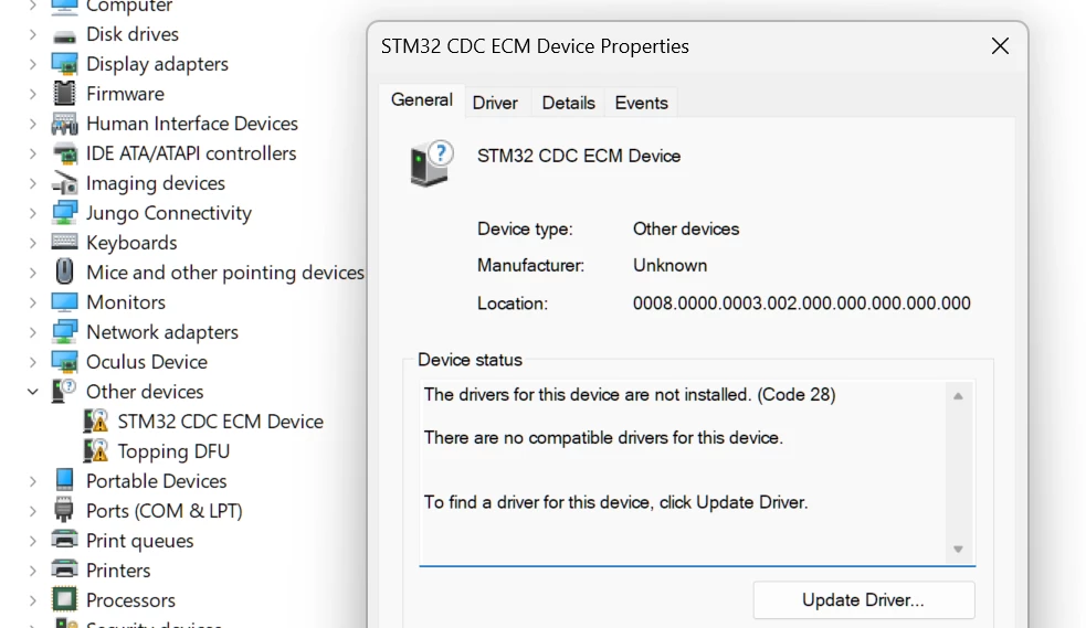

when attempting the CDC example for AzureRtos
I get this, I dono if this is helpful information to resolving this. 0693W00000aHTSgQAO.png

I resolved the issue,
the project with the default descriptor does not actually set anything up.
I followed this video for setting up the USB device
https://www.youtube.com/watch?v=3JGRt3BFYrM&ab_channel=STMicroelectronics
