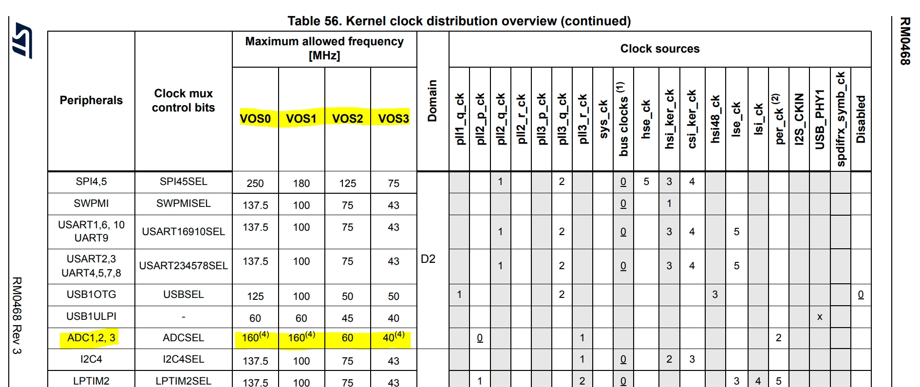

Can you help me to locate the relevant documentation about the limitation on the Fadc or due to voltage scaling? Until now I just found the reference manual "Maximum allowed frequency" in table 56 where it shows a max of 160 MHz (with VOS0 and VOS1) for clock to ADC, and the datasheet just seems to state that Fadc max of 16-Bit ADC is 50 MHz.
Thanks for the insights!
Kolja
February 16, 2022
In the reference manual, "Table 56. Kernel clock distribution overview"
Kolja Waschk
February 16, 2022
I currently have configured VOS1. Table 56 shows 160 Mhz limit with VOS1. How is this related to the limitation on Fadc that I experience? I get 126,5 MHz from PLL2P (which is below 160) and I'm not allowed to feed this divided only by 2 into f_adc_ker_ck_input, which (after another division by 2) would result in 31,5 MHz f_adc_ker_ck (which is below 160 and below 50). So there's still something I do not understand... Sorry...
