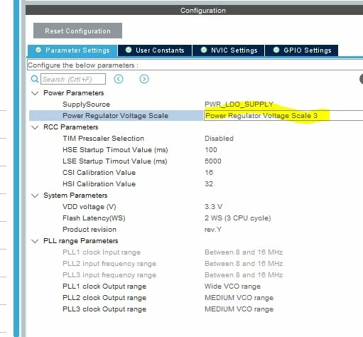

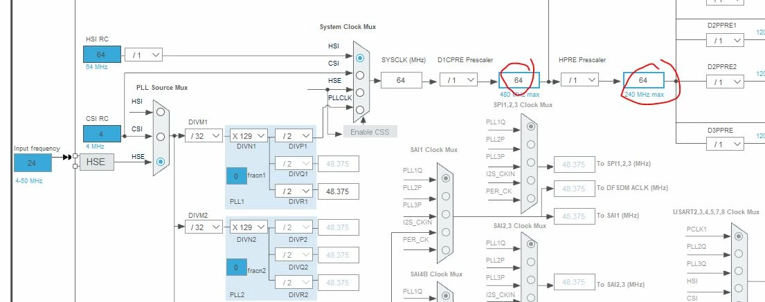

I cannot set the source clock frequency to 480 Mhz
cubeMx gives an error message: "Frequentcy searched for is out of range for this VOS range"
However, the VOS0: scale0 is normally set at 480/240 Mhz

I have found the reason about this problem:
The RCC Power Regulator Voltage Scale is default : Scale 3 !
I have set this to scale 0, and its works
