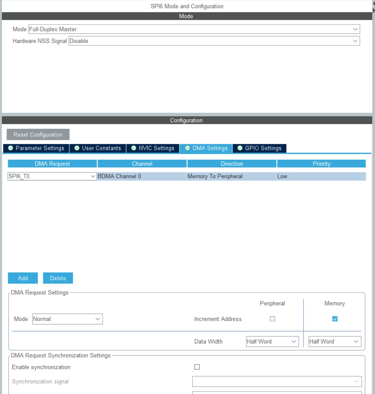

I have a project with an IOC configuring an STM32H733. In the IOC I configured the SPI6 in Full-Duplex Master. I also configured the BDMA channel 0 to serve requests of SPI6_TX. The project is pretty old and when I configured it like this I only enabled the BDMA channel 0 global interrupt (I did not really need to enable SPI6 global interrupt).
Recently I wanted to make modifications to my IOC and I had to migrate the project to the STM32CubeMX V6.7.0 with STM32Cube FW_H7 V1.11.0. With this migration now it seems that the STM32CubeMX forces the SPI6 global interrupt to be enabled and I cannot disable it (it is grayed out).
After some testing, I figured that this automatic force is caused by enabling BDMA for this SPI. I tried to find an answer without success in the release notes of the STM32CubeMX. I would like to know why the new version of IOC now forces the SPI6 global interrupt to be enabled. Can someone help me and shed some light on this?

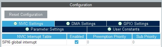

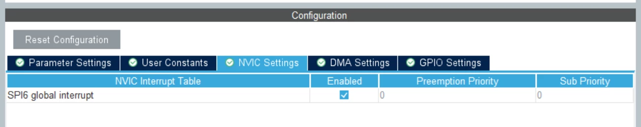

Hello @ANeam.1​ and welcome to the Community :)
Do you mean that you cannot "check/checkout" the SPI6 global interrupt t as in the below screenshot?

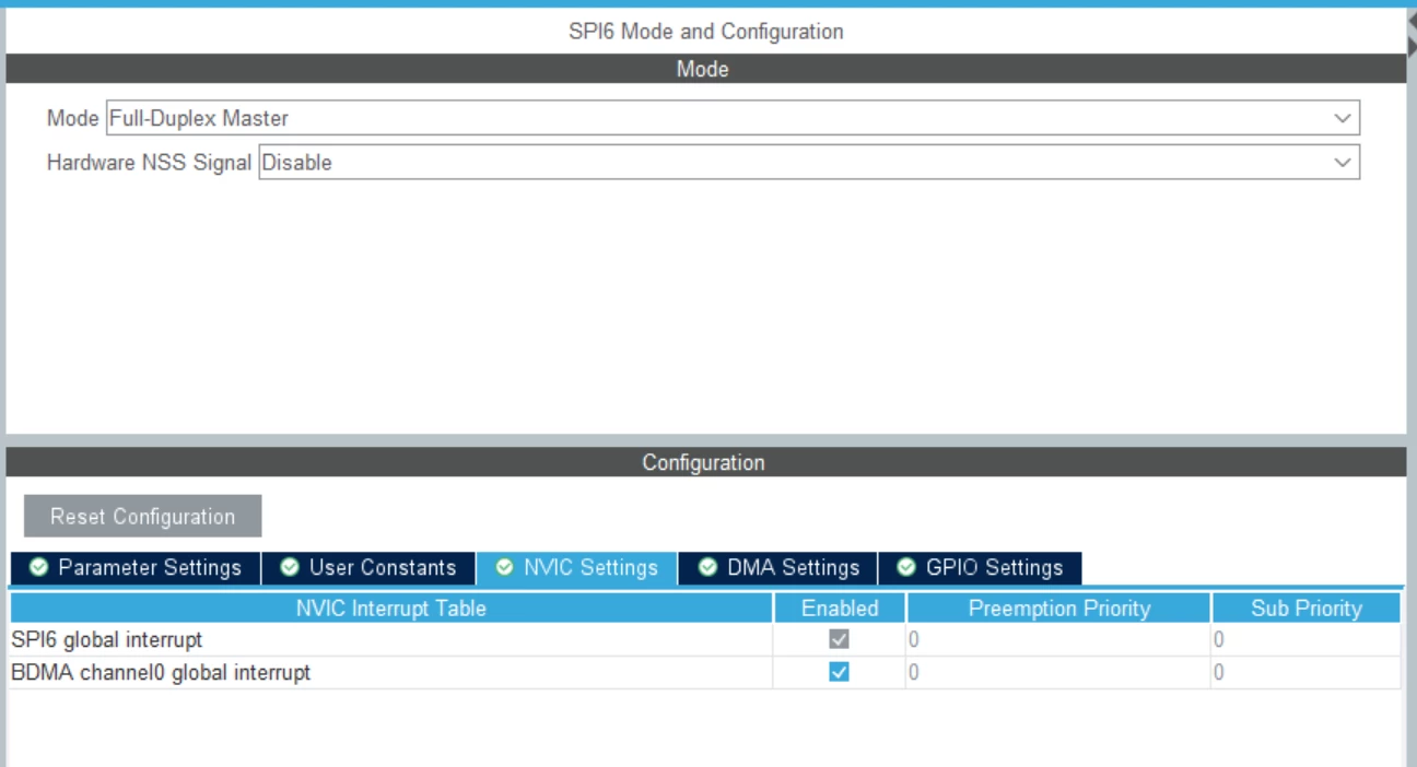

Hi Imen,
Yes, when the BDMA is configured, this checkbox you show in the picture is automatically checked and grayed out, so I cannot uncheck it :(
and now the checkbox is grayed out and cannot be disabled

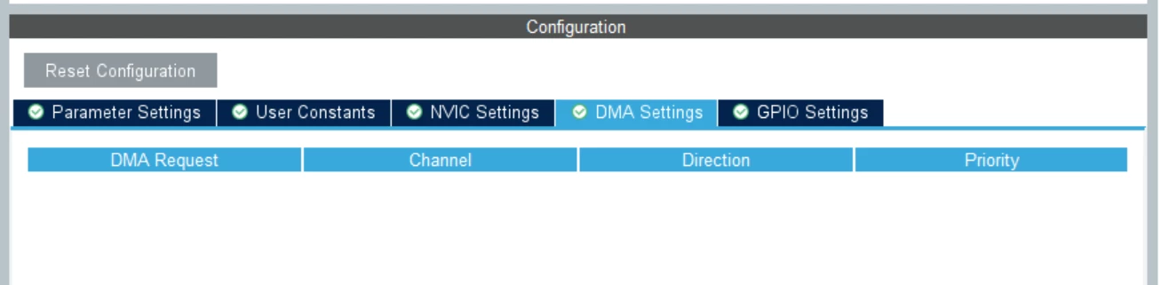

Of course, if I have no BDMA configured, I can check or uncheck the SPI6 global interrupt.

Hi @ANeam.1​,
BDMA is used with the SPI6 as BDMA_REQUEST_SPI6_RX/TX, because SPI6 itself is in D3.
The basic-DMA controller (BDMA) located in the D3 domain has only access to the resources located in that domain including Backup SRAM.
