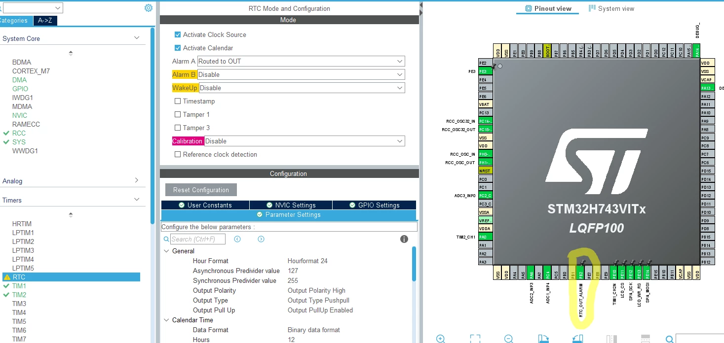

I'm trying to get an alarm signal on an external contact (PC13). In the program everything works as it should and the interrupt occurs, but nothing changes on the external contact. What did I miss?Screenshot_8.png

I make the settings in the cube, and the pc13 pin is automatically configured to RTC_OUT_ALARM. Or is something else required?

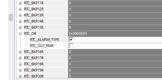

What about the bit value of RTC_ALARM_TYPE in RTC_OR register? is it configured in Open drain mode (value 0)? in that case you will not see anything on the pin.

The output is configured as push-pull. Vbat and VDD are different sources and are not related to each other.Screenshot_11.png

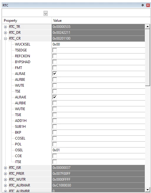

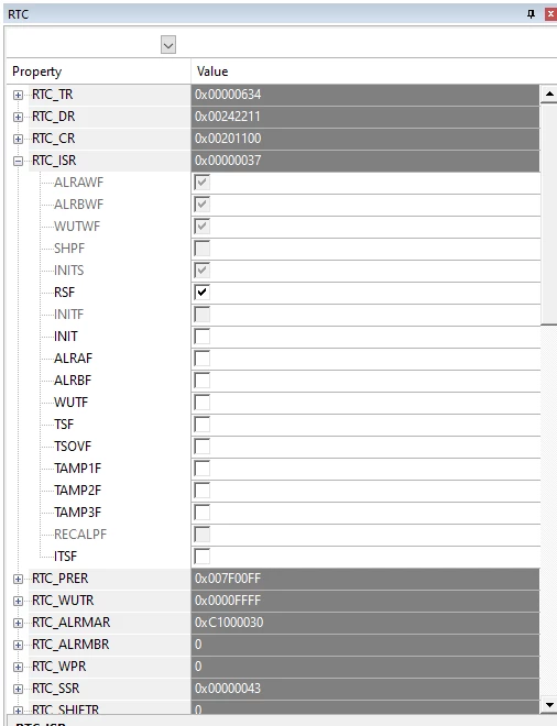

Read out and check/post all related RTC registers content, see GPIOs controlled by the RTC subchapter of RTC chapter in RM.

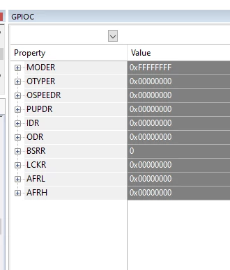

An oscilloscope is connected to pin PC13. Perhaps I don’t understand something, I set up an alarm clock in the cube and want to receive an alarm on the PC13 pin. I enabled interrupts and am just waiting for an event on the PC13 pin. And as I already wrote, there is nothing on the oscilloscope, and an interruption occurs. The situation changes if I set an alarm and turn off VDD, then when the alarm goes off, voltage appears on the PC13 pin and remains until I apply VDD again.CR.pngISR.pnggpio_c.png

All necessary bits are set
OSEL = 01             ALARM A
RTC_OUT_RMP = 0       NO REMAP (PC13 OUT )
RTC_ALARM_TYPE =1      PP MODE .

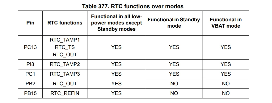

But whether it should work in active mode, this table does not say anything about this.RTC_FUNCTION.png

I don't see any reason why wouldn't alarm output work in Active mode of processor.
At this point you may want to contact ST directly, through FAE or web support form.
