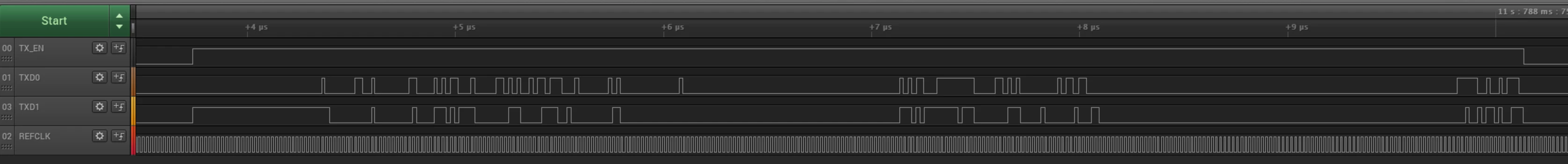

We are using STM32H743ZIT6 revision V.
This is connected to an ethernet PHY device via RMII. The PHY outputs the 50MHz RMII REFCLK to drive the RMII on the STM.
According to the following sources, the RMII TX data lines (TXD0 and TXD1) should be sampled by the PHY on the rising edge of the REFCLK, and thus should transition around the falling edge:
  • official RMII spec
  • STM32H7 datasheets Table 112. Dynamics characteristics: Ethernet MAC signals for RMII
  • the timing diagrams from the PHY

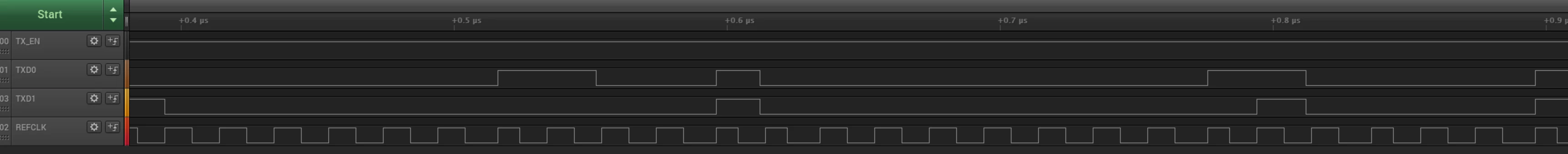

This is not what I am seeing. The STM seems to be transitioning the TX data lines on (or near) the rising edge of REFCLK. We are getting CRC errors detected at the PHY on the RMII interface side.
The trace attached shows a packet going out on the RMII. The scope resolution is 2ns, so it's possible the data lines do transition just before the clock edge, but according to the timing diagrams the transition should be at least 2ns before a clock rising edge.
Any idea how to solve this? I didn't manage to find a way to invert the clock at either end (PHY or STM). The PHY supports RGMII clock delay, but only on RGMII, not RMII.
Thanks, Kieran.

Changing the drive strength on the TXD0, TXD1 and TX_EN signals to HIGH (they default to LOW from cubeMX) seems to push the timing into bounds, and the CRC errors on the PHY are gone.
Hopefully that may help someone else...
Thanks, Kieran.

Also on H7 watch that the compensation cell is enabled.
 Note : The activation of the I/O Compensation Cell is recommended with communication interfaces
     (GPIO, SPI, FMC, QSPI ...) when operating at high frequencies(please refer to product datasheet)
     The I/O Compensation Cell activation procedure requires :
    - The activation of the CSI clock
    - The activation of the SYSCFG clock
    - Enabling the I/O Compensation Cell : setting bit[0] of register SYSCFG_CCCSR
     To do this please uncomment the following code
 __HAL_RCC_CSI_ENABLE() ;
 __HAL_RCC_SYSCFG_CLK_ENABLE() ;
 HAL_EnableCompensationCell();
Piranha
Principal III
Dec 18, 2019 6:51 PM UTC
https://www.st.com/resource/en/datasheet/stm32h743zi.pdf
Table 63 suggests that in a typical case medium speed is the most appropriate one. I'm using medium speed for RMII pins on multiple F7 based boards without problems. Also take a note that at these speeds the measurement probe can distort the signal and what you see could not be the original signal without probe.
