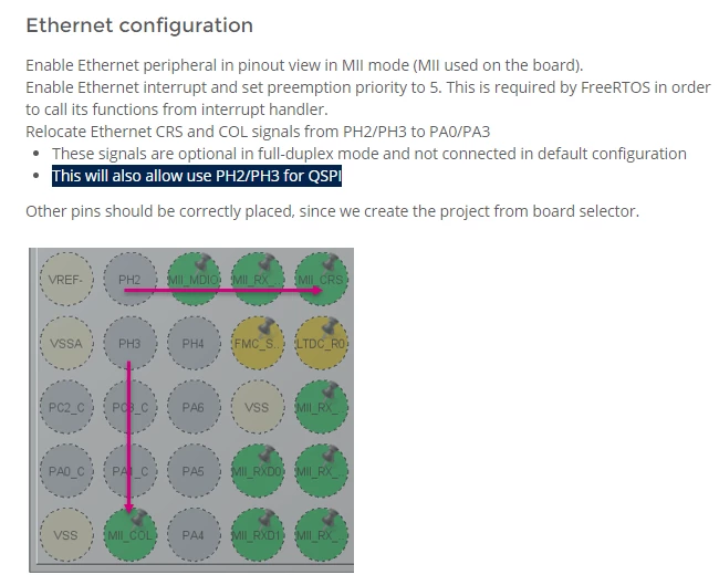

I'm confused regarding the importance of Quad-SPI for Ethernet communication. I see that pins PH2/PH3 were configured for QSPI without it being activated for either core. I tested leaving these pins in GPIO_Analog mode and still detected UDP broadcasts from the example code. Are these Quad-SPI pin configurations optional?

@Adam BERLINGER​  will tell it for sure, but I'm reading it as "as in 'H750 there's deliberately quite little FLASH so most probably you'll need external FLASH, probably QSPI-connected".
In other words, no, it's not directly ETH-related.

Just flagging potential conflicts, and more optimal pin choices that don't foreclose other usage.

Note that these pins are for MII interface. In RMII mode there's no conflict at all.

yes,
This is due to pin collision in pinout. Moving MII signals from PH2/PH3 allows to use QuadSPI later on if necessary. But it is not required for Ethernet operation.
This is also related to this specific H7 board.
