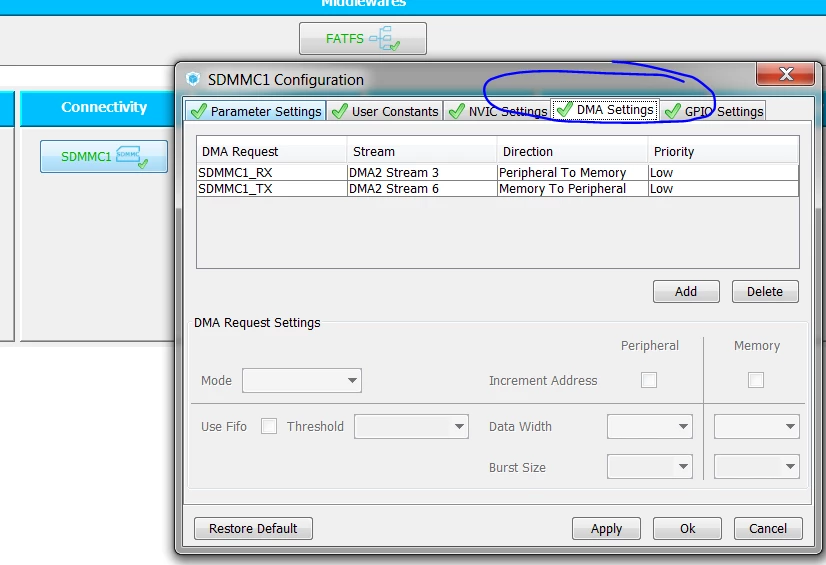

I am trying to use SDMMC/SDIO with DMA + FATFS.
When creating project on stm32f7, I can find and configure DMA streams for the sdmmc.
I am working with cubeMX version 4.23.
Screenshot from STM32F7 - DISCO cube configuration:

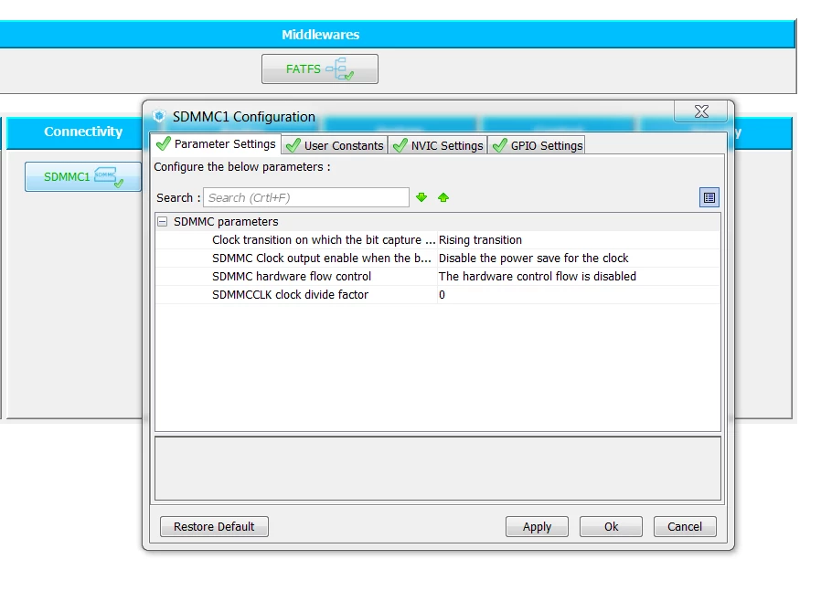

Screenshot from STM32H7- NUCLEO cube configuration:
Does the cube missing a DMA tab in SDMMC configuration? Maybe it defined in another place in the cube?

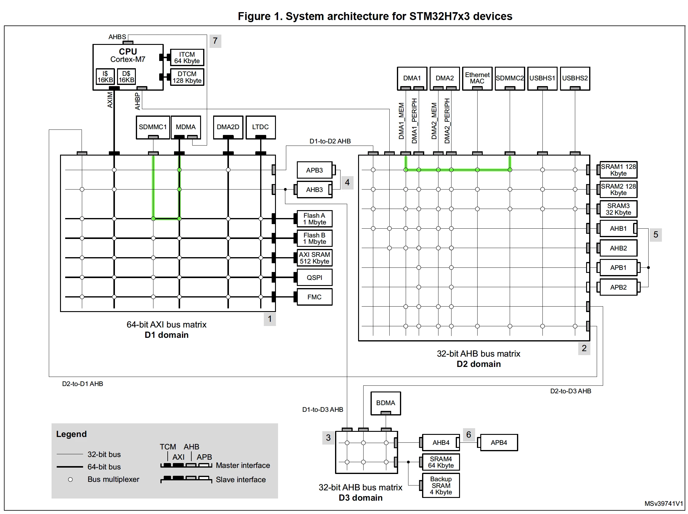

Hi Marina.
The basic DMA is not more available for SDMMC1, just for SDMMC2 only.
To use the DMA feature you have to work with MDMA. It's in the same D1 domain.

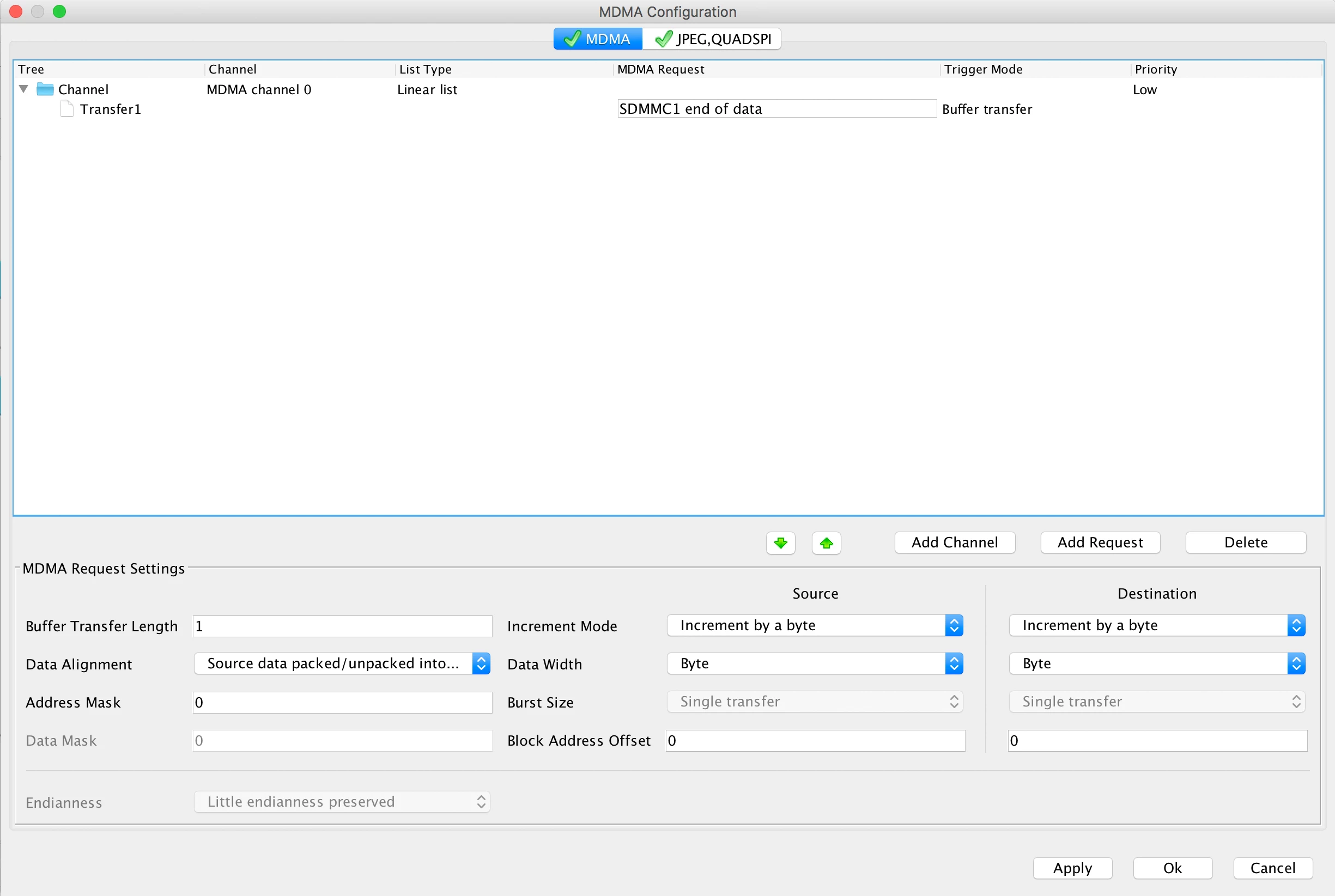

If I should work with the MDMA, can it be defined to work with the SDMMC via the cube?
Marina

On page 100 in the Reference Manual you can see the interconnects.
Only SDMMC2 resides in the D2 domain.
You can use MDMA in CubeMX:
