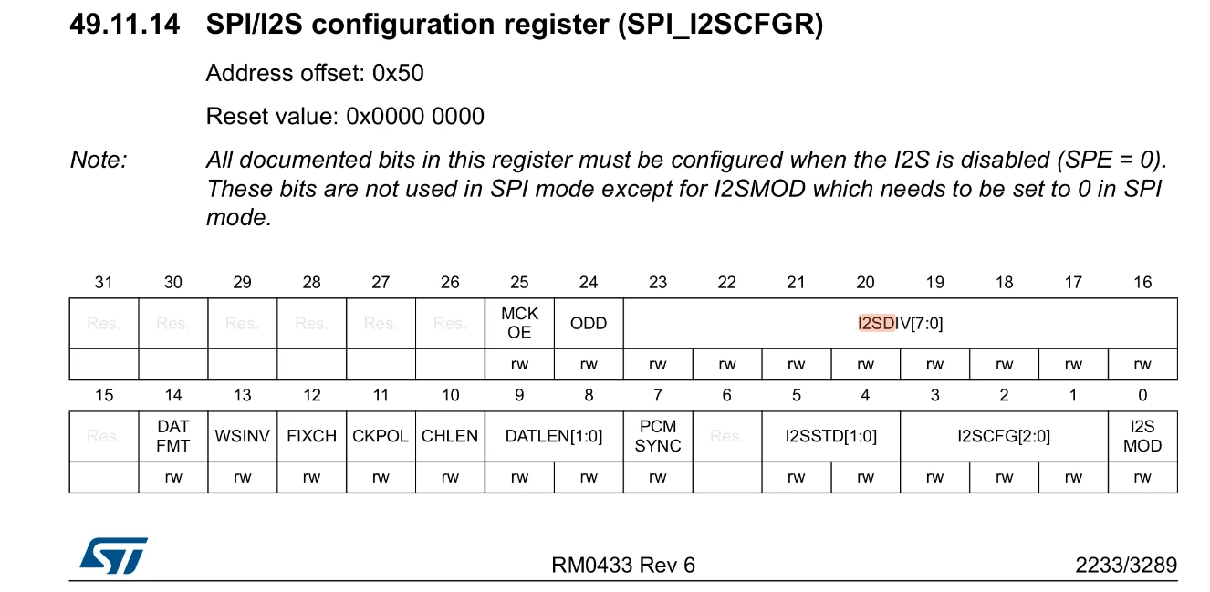

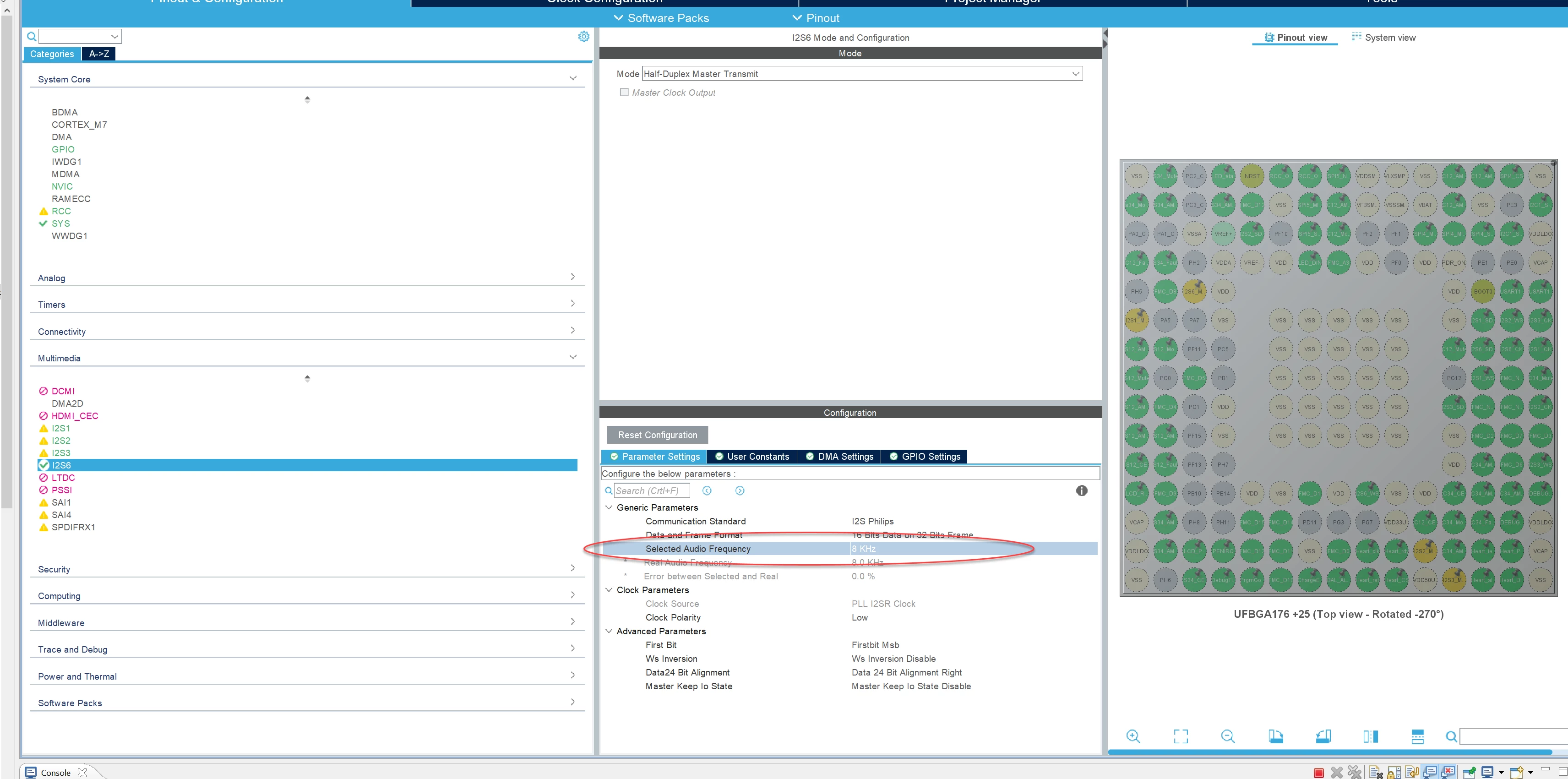

STM32H7 Is there a way to go lower than 8kHz Audio Frequency on I2S
Is there a way to go lower than 8kHz sampling Audio Frequency on I2S?
If so, how would I go about it manually adding in the code?
Thanks!

There is 8-bits divider:

Tesla DeLorean
Guru
Jul 29, 2021 11:45 PM UTC
Try picking a close multiple and fiddle the values in the PLL or prescalers

Jul 30, 2021 1:19 AM UTC
