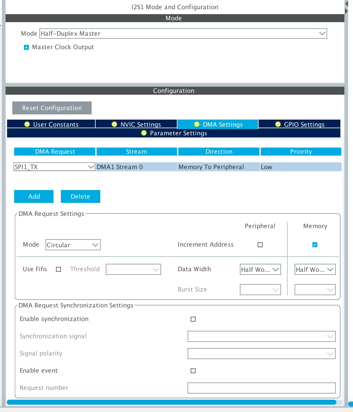

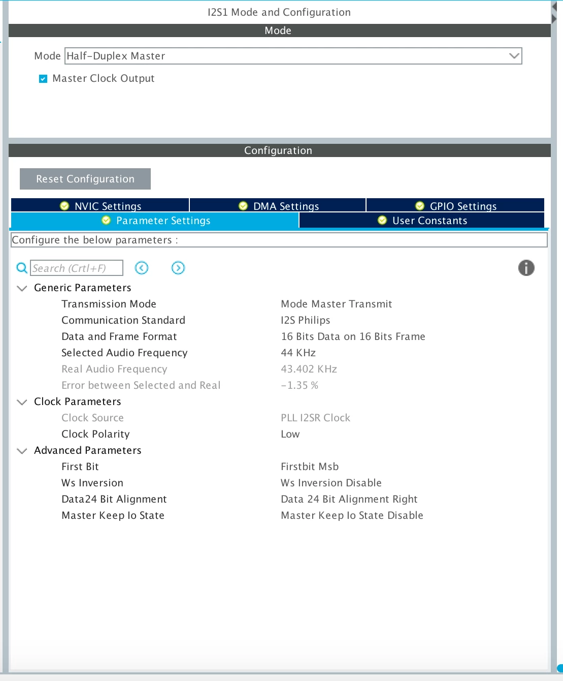

I try to operate very basic I2S DMA function in STM32H750 chip. This is a very simple function which successfully works on STM32F4 and F7 chips.
I have read the previous comments about I2S problems on H7 chip, and know
there are some problems with I2S in previous releases of HAL library, but with the release of v.1.50. this library was rewritten.
Right know, polling mode and interrupt mode are successfully working.
For DMA problems on H7, the linker script is re-edited. I2C and SPI DMA functions are working successfully, but I2S function starts without any errors, finishes 1 cycle successfully, then halts. It does not work in neither normal nor circular mode.
In debug mode, HAL_I2S_TxHalfCpltCallback is called after one cycle, then it halts. No error callbacks are called. Below tryouts were not successful either;
  • placing dma buffer on RAM_D2
  • using cache maintenance functions (SCB_CleanDCache)
  • using I2S2 or I2S3
Solving this problem is very crucial for my project. Project files are attached.Any help or suggestion would be apreciated.

void MX_I2S1_Init(void)
 hi2s1.Instance = SPI1;
 hi2s1.Init.Mode = I2S_MODE_MASTER_TX;
 hi2s1.Init.Standard = I2S_STANDARD_PHILIPS;
 hi2s1.Init.DataFormat = I2S_DATAFORMAT_16B;
 hi2s1.Init.MCLKOutput = I2S_MCLKOUTPUT_ENABLE;
 hi2s1.Init.AudioFreq = I2S_AUDIOFREQ_44K;
 hi2s1.Init.CPOL = I2S_CPOL_LOW;
 hi2s1.Init.FirstBit = I2S_FIRSTBIT_MSB;
 hi2s1.Init.WSInversion = I2S_WS_INVERSION_DISABLE;
 hi2s1.Init.Data24BitAlignment = I2S_DATA_24BIT_ALIGNMENT_RIGHT;
 hi2s1.Init.MasterKeepIOState = I2S_MASTER_KEEP_IO_STATE_DISABLE;
 if (HAL_I2S_Init(&hi2s1) != HAL_OK)
 Error_Handler();

Best answer by eeyurdakul
MX_GPIO_Init();
MX_I2C3_Init();
MX_I2S1_Init();
MX_DMA_Init();
STM32Cube automatically generates init functions, but the order is false, MX_DMA_Init() should be the first.
MX_DMA_Init();
MX_GPIO_Init();
MX_I2C3_Init();
MX_I2S1_Init();
This solves the problem, right now it works both in normal and circular mode.
