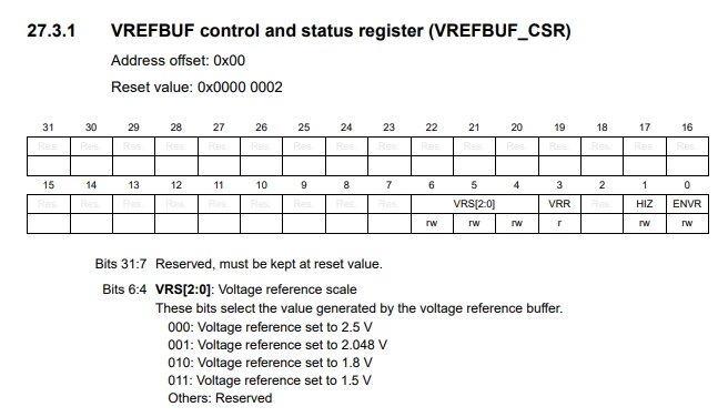

While you guys are looking into fixing that, maybe also have a look on this other bug:
Selecting 2.5V reference in cubeMx gives out this code in stm32h7xx_hal_msp.c, which seems correct:
HAL_SYSCFG_VREFBUF_VoltageScalingConfig(SYSCFG_VREFBUF_VOLTAGE_SCALE0);
but then one can see this weird re-shuffling in stm32h7xx_hal.h:
#define SYSCFG_VREFBUF_VOLTAGE_SCALE0 VREFBUF_CSR_VRS_OUT2 /*!< Voltage reference scale 0 (VREF_OUT2) */
 #define SYSCFG_VREFBUF_VOLTAGE_SCALE1 VREFBUF_CSR_VRS_OUT1 /*!< Voltage reference scale 1 (VREF_OUT1) */
 #define SYSCFG_VREFBUF_VOLTAGE_SCALE2 VREFBUF_CSR_VRS_OUT4 /*!< Voltage reference scale 2 (VREF_OUT4) */
 #define SYSCFG_VREFBUF_VOLTAGE_SCALE3 VREFBUF_CSR_VRS_OUT3 /*!< Voltage reference scale 3 (VREF_OUT3) */
#define VREFBUF_CSR_VRS_OUT1 ((uint32_t)0x00000000) /*!<Voltage reference VREF_OUT1 */
#define VREFBUF_CSR_VRS_OUT2_Pos (4U)
#define VREFBUF_CSR_VRS_OUT2_Msk (0x1UL << VREFBUF_CSR_VRS_OUT2_Pos) /*!< 0x00000010 */
#define VREFBUF_CSR_VRS_OUT2 VREFBUF_CSR_VRS_OUT2_Msk /*!<Voltage reference VREF_OUT2 */
#define VREFBUF_CSR_VRS_OUT3_Pos (5U)
#define VREFBUF_CSR_VRS_OUT3_Msk (0x1UL << VREFBUF_CSR_VRS_OUT3_Pos) /*!< 0x00000020 */
#define VREFBUF_CSR_VRS_OUT3 VREFBUF_CSR_VRS_OUT3_Msk /*!<Voltage reference VREF_OUT3 */
#define VREFBUF_CSR_VRS_OUT4_Pos (4U)
#define VREFBUF_CSR_VRS_OUT4_Msk (0x3UL << VREFBUF_CSR_VRS_OUT4_Pos) /*!< 0x00000030 */
#define VREFBUF_CSR_VRS_OUT4 VREFBUF_CSR_VRS_OUT4_Msk /*!<Voltage reference VREF_OUT4 */
But according to the manual there should be no re-shuffling:
