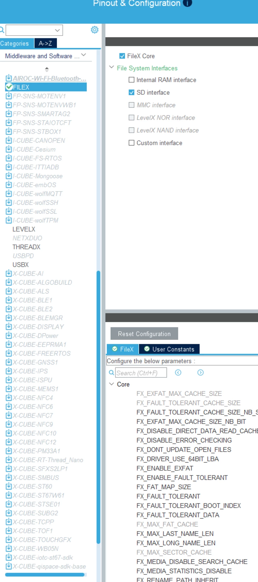

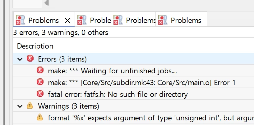

Hi Everyone,
I need your help.
I use STM32H573VIT but I can't FATFS in CUBEMX.
I checked FILEX, SD interface. But CUBEIDE say fatfs.h : No such file or directory.
Please help me out..
Thanks,
kadekade

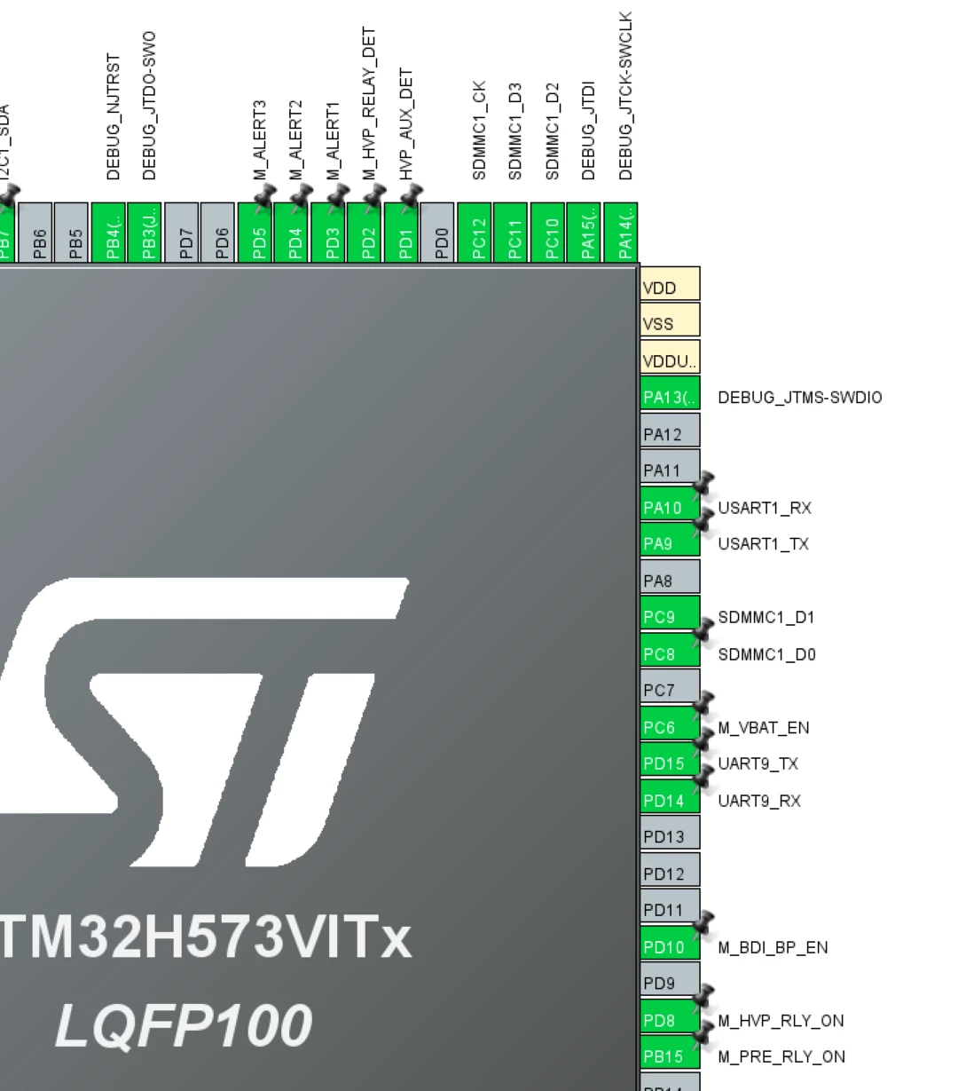

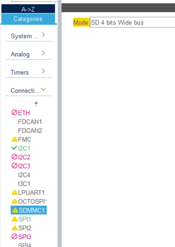

I attatched my ioc file. My settings is slightly defferent with your settings(SDMMC1_D0)
yours : SDMMC1_D0 PB13
me : SDMMC1_D0 PC8
I going to try testing with your ioc file.
Thanks,
kade

>but I can't FATFS
Right, here no fatfs , you have to use filex , as you selected in Cube.
mount drive ->
/* Open the SD disk driver */
 sd_status = fx_media_open(&sdio_disk, FX_SD_VOLUME_NAME, fx_stm32_sd_driver, (VOID *)FX_NULL, (VOID *) fx_sd_media_memory, sizeof(fx_sd_media_memory));
