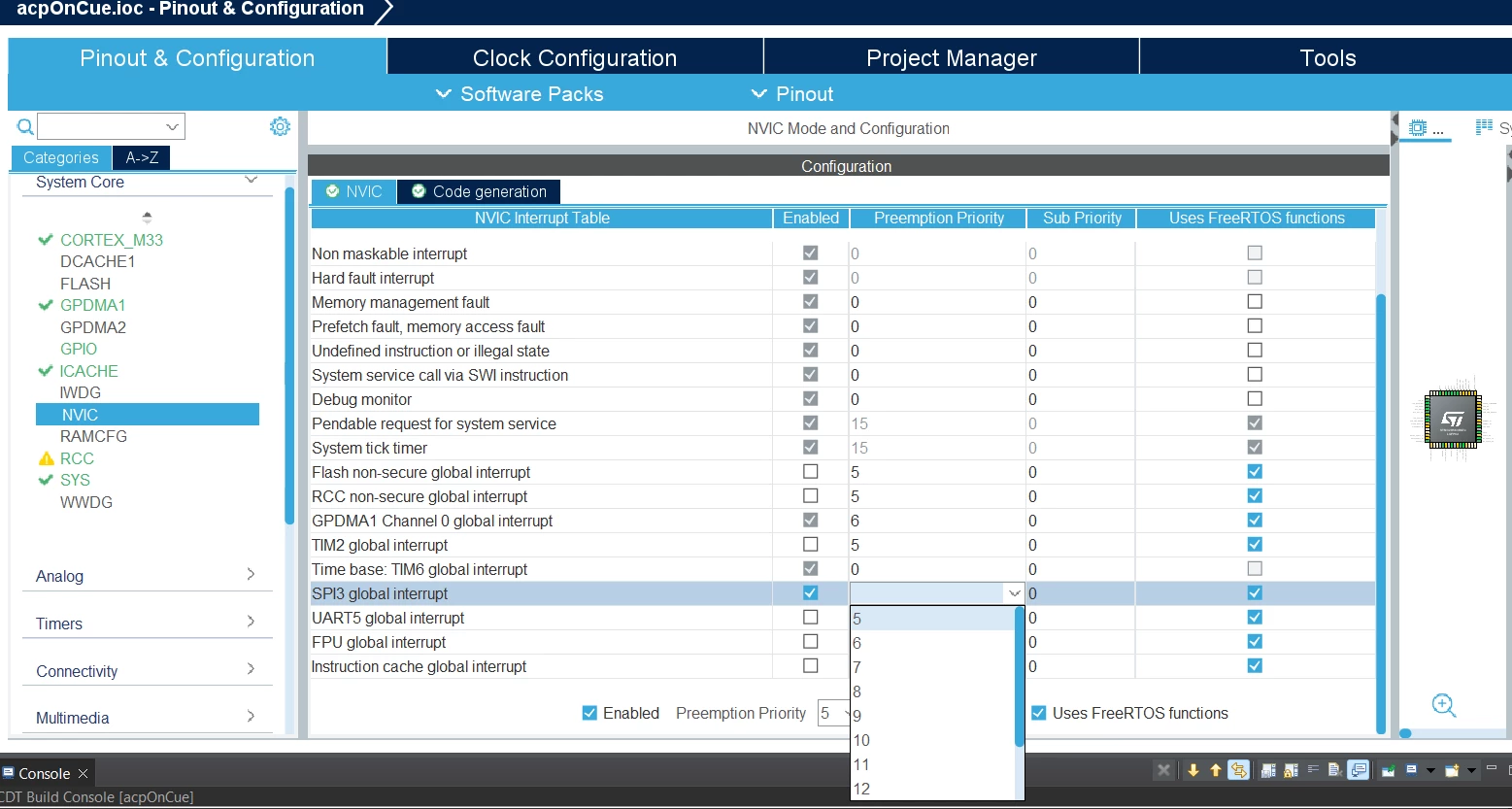

Turns out there was a problem introduced that caused the FreeRTOS kernel not to run correctly which seems to be blocking the interrupts.
I believe when FreeRTOS is used it reserves priority level below 5 except systimer, so all other interrupts must use priority 5 or above.
Once the FreeRTOS issue was resolved the SPI/DMA transfer worked as expected with SPI priority set to 5 and DMA set to 6
