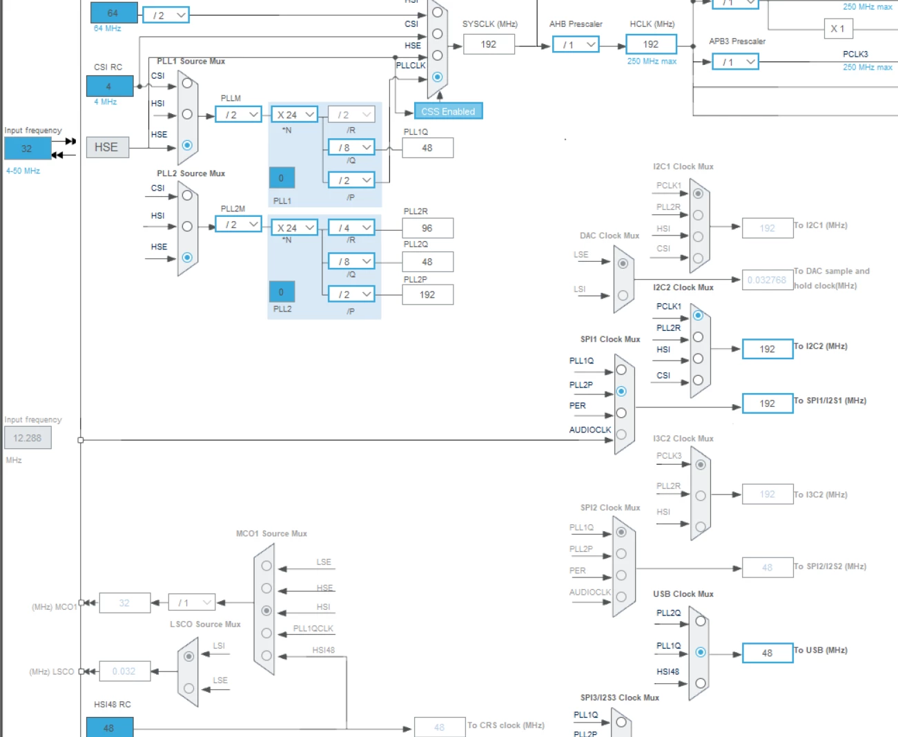

I'm working on a project with the STM32H503CBU7 which requires USB. I have a 32MHz external crystal on my board that appears to be stable. The chip works and can be programmed and such. I also troubleshot out other physical issues like cold joints and shorts because that has burned me before when the USB device fails to enumerate.
My intent was to use the PLL2Q source with the USB peripheral so I could also specify a 200MHz sys clock for everything else via PLL1. When I use the PLL2Q source however,  I get no interrupts from the `USB_DRD_FS_IRQHandler` handler and so my USB stack does not operate.
To make things more confusing, it also does not work even when both PLL's have the same values set for all parameters, as shown in the image below.
It is important to note that this works with the PLL1Q source, as it is shown in the image, and I'm currently compromising a little on the sys clock speed. It will work for my purposes, but I'm more interested to know whether there's some "magic bullet" setting I'm missing, or if this could be a known configuration limitation.
The generated code in my `main.c` file that configures the peripheral clocks seemed to be okay, so I don't think it is a code auto-gen issue, but I could also be wrong about that.
I have already tried this on two chips because I thought there could be something wrong with the first, but they both exhibit this behavior.

For clarity, you said the configuration in the screenshot works, yes?
But if you change the radio button from PLL1Q to PLL2Q without changing anything else, it no longer works?
Shouldn't be a magic setting anywhere. Does it fail to enumerate? If you debug your code, does it make it past initialization and through MX_USB_Init okay?

Yes, that's the confusing part: both PLLs based off the HSE with the same MHz configured, but with PLL2Q no interrupts are triggered whereas PLL1Q they are.

I did some experiments to check the case described on Nucleo-H503. USB is operating correctly with HSI48 and HSE/PLL2Q. I attach the minimal code for HSE/PLL2 setup. It mighty be useful for checking the RCC register content in a debug session. In my code, both PLLs are configured in the same way. USB clock source is selected by setting RCC->CCIPR4;

Thanks to both @gbm and @TDK for the recommendations to check the registers while debugging!
I found that the PLL2QEN bit was not getting set in the RCC->RCC_PLL2CFGR register due to a code auto-gen bug in CubeMX (6.16.1).
This is the default line of code generated when PLL2Q is selected in the clock config UI:
 PeriphClkInitStruct.PLL2.PLL2ClockOut = RCC_PLL2_DIVP|RCC_PLL2_DIVR;
It should actually be
 PeriphClkInitStruct.PLL2.PLL2ClockOut = RCC_PLL2_DIVP|RCC_PLL2_DIVR|RCC_PLL2_DIVQ
Because all three outputs are in use.
