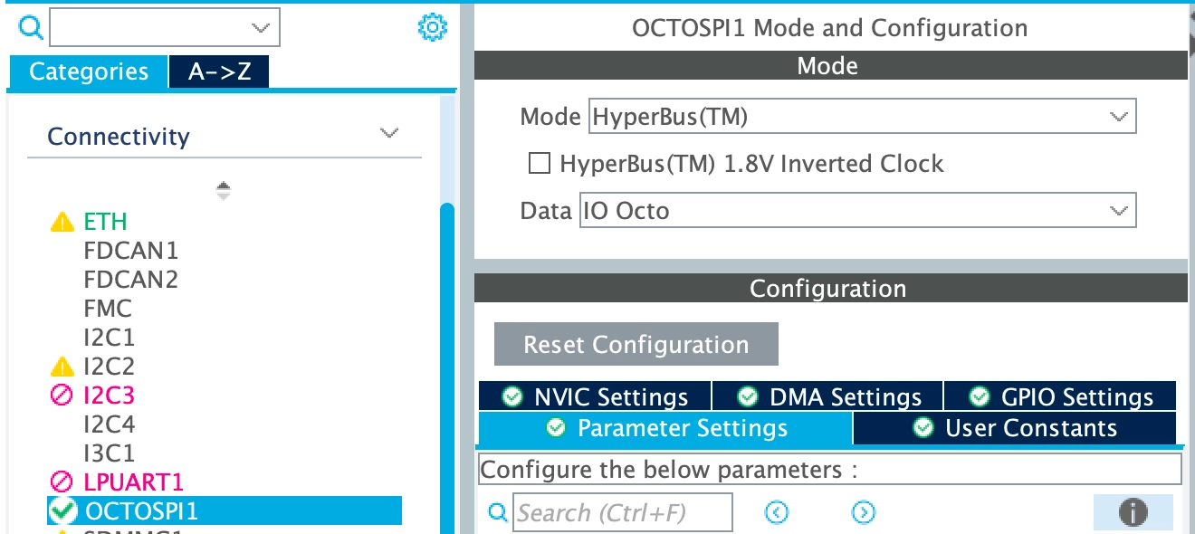

Hello everyone,

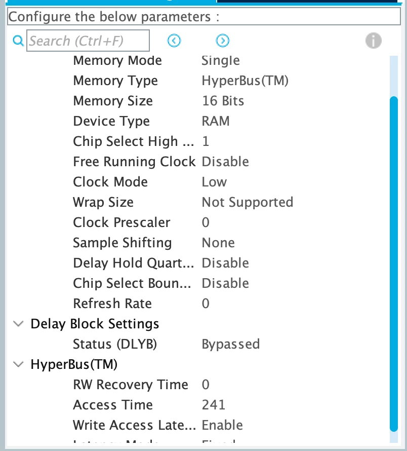

I was trying to design a Hyperbus RAM based PCB for one of my projects but I realized that when I configure Hyperbus under the OCTOSPI1 settings I do not get the DQS(RWDS) line. Here are the configuration pictures.
Thanks,
Burak Önemli

Hello @burakOnemli and welcome to the community,
I will check internally this point and get back to you as soon as I have a feedback (internal ticket 191726 for follow-up).

Hello @burakOnemli ,
The limitation is confirmed.
Sorry for any inconvenience.

November 27, 2024
Fixed in CubeMX 6.13.0
